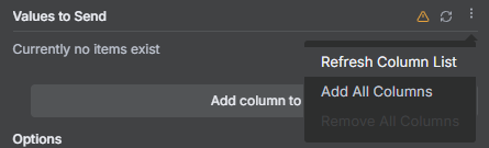

Today I’m trying to create a new automation that requires using the G-Sheets nodes - cannot get them to work - no errors being received.
For example, I’m trying to use a simple ‘Append row in sheet’ operation…
As a test, I have entered fixed values, no expressions.
It will only output the data for the first column - nothing else is output.

Yes, I manually refreshed the columns to make sure they are an exact match.
Also, tried new G-Sheet nodes > refreshing the workflow > restarting my n8n instance.

Hi @sw2025,
Good news, I was able to replicate the issue exactly as you described :smiley:
It comes down to how the columns are named!
For example, this column name contains a newline:
This will not be recognized by n8n which i do not know if it’s a bug or no..
However, the same name without a newline works correctly:
Please test it on your side and let me know if it works.
