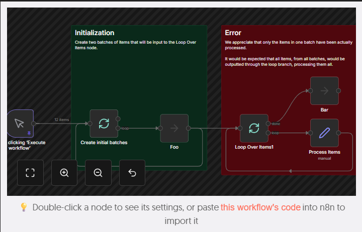

Steps to Reproduce
Create a workflow where two or more batches of items are produced (for example by using a first loop over items that produces two or more batches)
Make a Loop Over Items node receive those batches.
Execute the workflow.
Observed Behaviour
The second loop receives all items but only processes one atch.
The node receives all items (confirmed by inspecting input), but decides not to process most of them.
When the exact same logic is wrapped inside a subworkflow, all items are processed correctly.

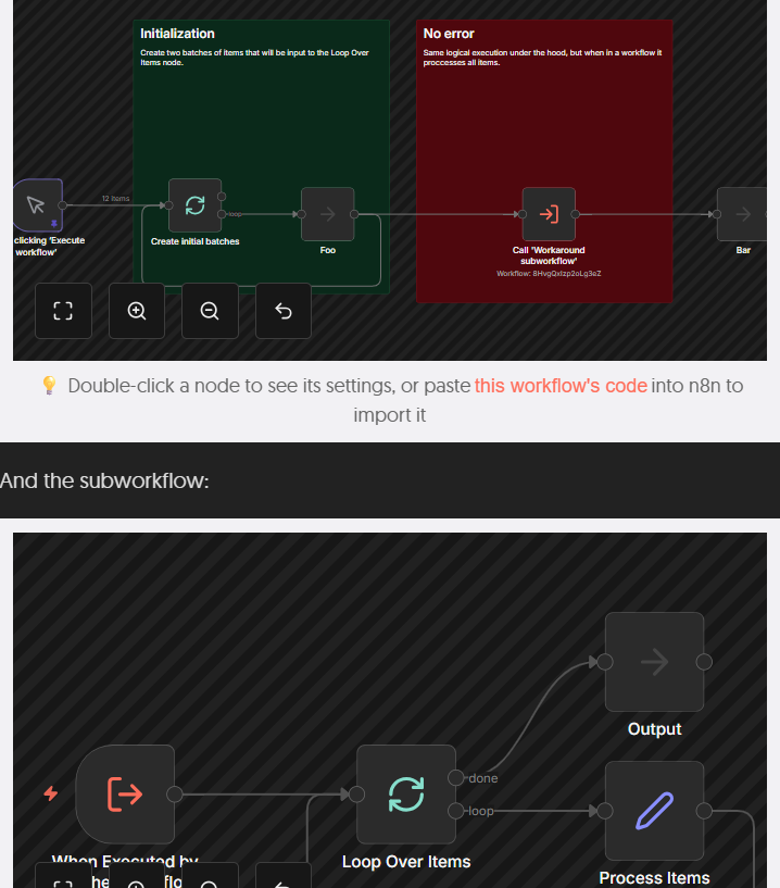

Workaround
Encapsulate the loop logic inside a subworkflow. When the Loop Over Items node is placed inside a subworkflow, all items are processed correctly, even with multiple incoming batches.
Example can be seen in the thread’s last answers, as show here:
