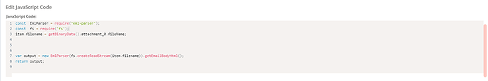

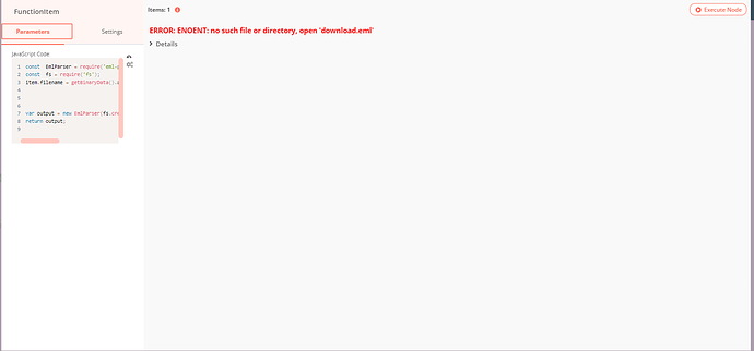

I have this function item node I’m trying to get the email and parse but I’m getting the below error:
My Node Function Item node

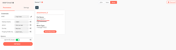

Imap node that returns the attached email and there is the file.

Hi @hermanmaleiane , the file data is stored in memory, thus you need to use the .data field from the attachment. Then you convert it into a stream.
first, you need to enable the ‘stream’ module by running the next command in your console and restart n8n instance
    export NODE_FUNCTION_ALLOW_BUILTIN=stream
then you apply this code in the Function item node, don’t forget to add the email parsing part
const { Readable } = require('stream');
// retrieve the base64 encoded data (from the attachment)
const data = getBinaryData().attachment_0.data;
// convert it into a buffer
const buff = new Buffer(data, 'base64');
// create a stream
const stream = Readable.from(buff.toString());
 Your code to parse the email using email_parser
console.log(stream);
return item;
let me know if that works in your case.

I’m getting this error:
It’s only accepting buffer as parameter and not stream.
