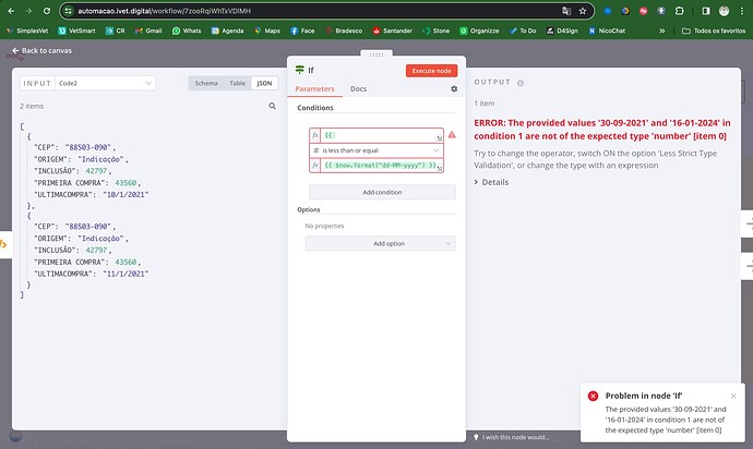

I didn’t work for myself!
…even activating the Less Strict Type Validation option
What error in a first condition?
You should put there
{{ $json.ULTIMACOMPRA.toDate().minus(day=30).format("dd-MM-yyyy") }}

Use this
{{ $json.[“ULTIMACOMPRA”].toDate().minus(day=30).format(“dd-MM-yyyy”) }}
So {{ $json.ULTIMACOMPRA }} shows the date as I can see. Start adding functions one by one and see which one causing a problem.
Does {{ $json.ULTIMACOMPRA.toDate() }} works?
Probably because when it tried to convert, the date was already in the wrong format. To correctly convert the date, it should be in MM/dd/YYYY format. However, you provided it in dd/MM/yyyy format. And of course, on Earth, there is no 13th month. :slight_smile:
