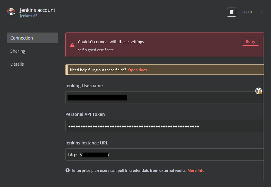

Add option to ignore SSL on jenkins integrations
My use case:

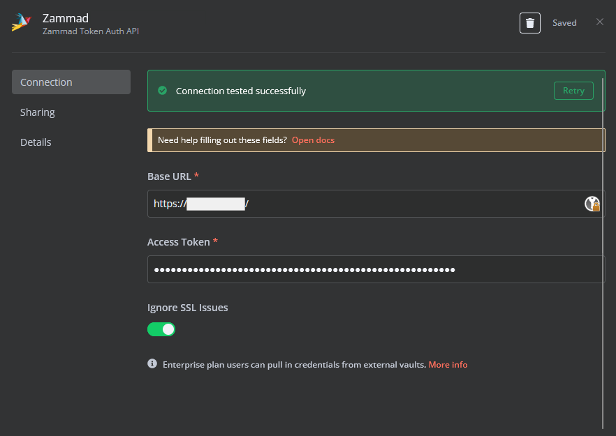

I have a self hosted N8N on a local network with another Jenkins and Zammad. Everyting is https with self-signed certificates as it is just local access. Zammad integration has a Ignore SSL errors options, but Jenkins does not have it:
Integration working with self-signed https certificate with jenkins

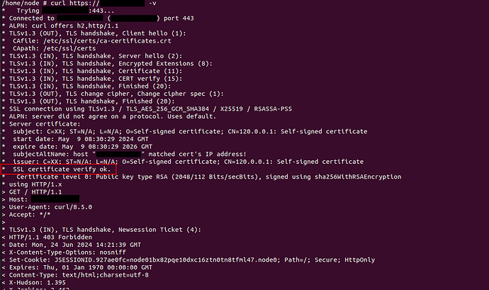

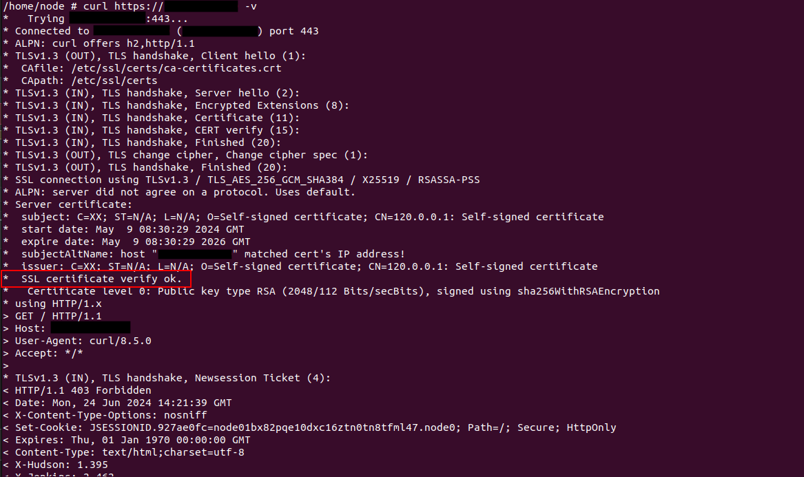

At the moment I tried to follow this old post to install the root CA and i could access Jenkins from the container terminal, but not from N8N workflows:
I dont find any manuals for this feature
Hey @Adrian_Negro_Perez,
I have not yet documented that process, If you wanted to try that instead create a folder with your CA cert in it and map it to /opt/custom-certificates in the container then stop and start the container and it should pick it up.
