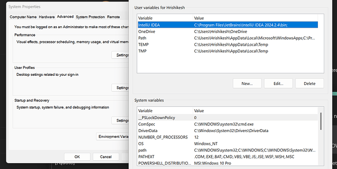

That would happen when this is not correctly set:
When that variable is correctly set and Node.js built-ins are correctly available, process is automatically available. Have you tried setting the environment variables in Windows settings?
Open Start and search for Environment Variables, you’d find a screen where you can add it:
