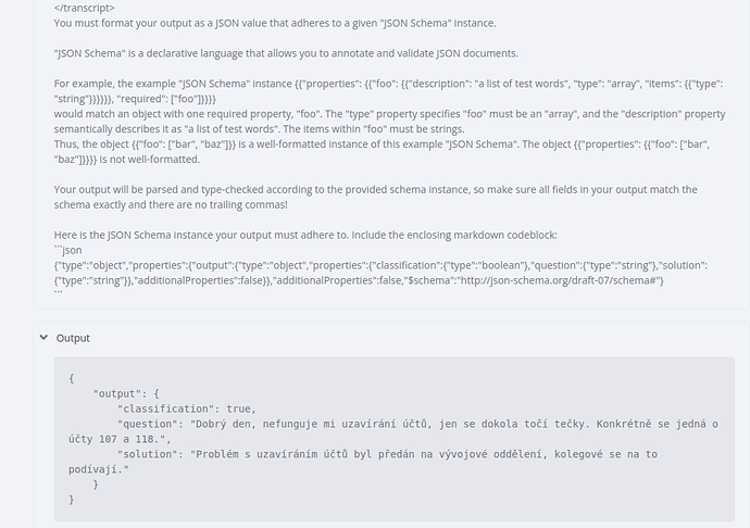

I’m trying to setup the json parser on my end but it occasionally runs into this error:
AI Agent error output:
Model output doesn't fit required format
Json output parser output:
    "action": "parse",
    "response": {
      "output": {
        "value 1": "actual value",
        "value 2": "actual value"
Json example that I gave:
	"value 1": "output 1",
	"value 2": "output 2"
Am i missing something?

I have exactly the same problem. I’ve set up JSON output parser with configured schema and still getting this error even when the response fits schema.
Yeah :confused: I tried to take a really good look at both working outputs and non working outputs but there is basically no difference in the schema…
Oh and the auto fixing tool usually can’t fix this either
