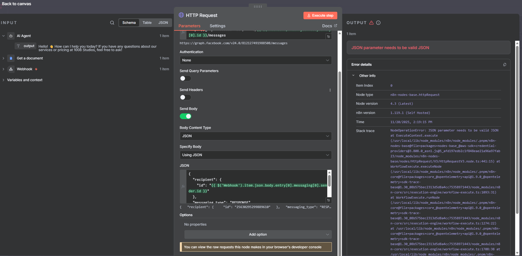

JSON parameter needs to be valid JSON on http request
Not sure what is wrong with the json

same here.. problem with the http request

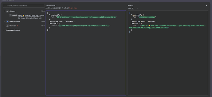

This is the body json script. but mine is have same error
“recipient”: {
“id”: “{{ $(‘Webhook’).item.json.body.entry[0].messaging[0].sender.id }}”
“messaging_type”: “RESPONSE”,
“message”: {
“text”: “{{ $json.output }}”
{{ JSON.stringify($json.output) }} should be in your case @Mavz_Ocampo .
And as summary @NUNEZ_JOSHUA_S either use JSON.stringify() or .replace()

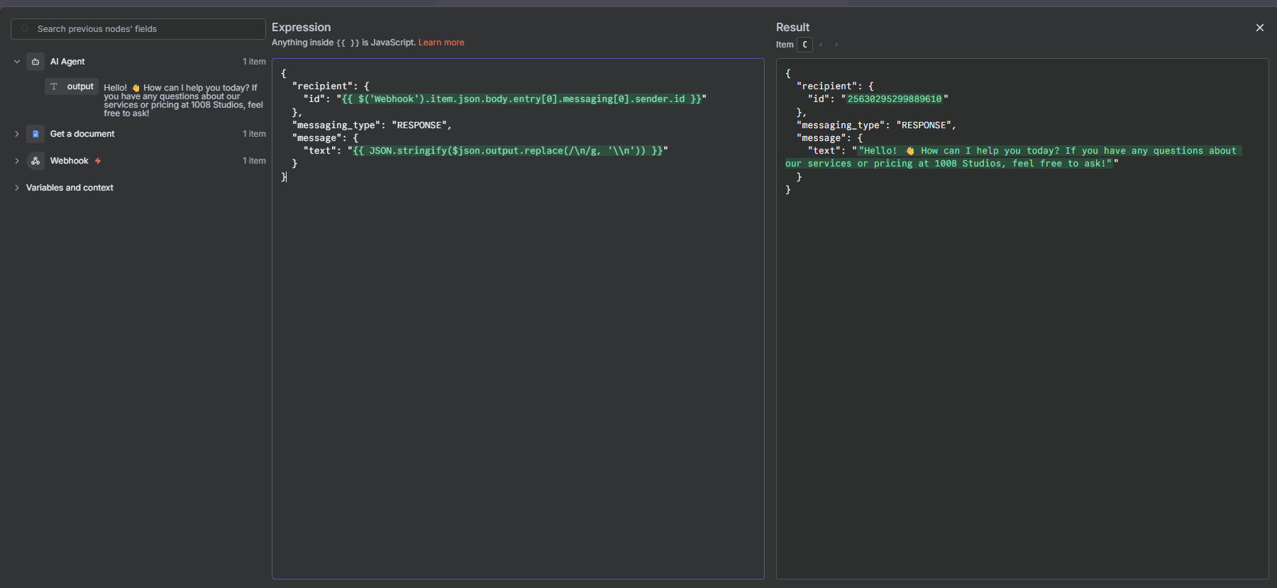

hello thank you, somehoe is still errors, is this how it should look like ?
Do you see “” sign at your output :
“text”: ""Hello :waving_hand: How…
You have doubled the " quotes sign. That extra " sign breaks your json in your request.
if you can understand filipino you can check Koya RJ in youtube.
“message”: {
“text”: {{ JSON.stringify($json.output.replace(/\n/g, ‘\n’)) }}
