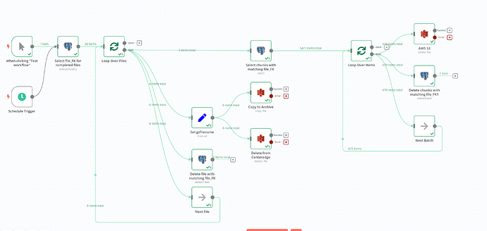

Here is an example where I tried to have a loop within a loop. I have a few dozen large CSV files that are cut up into smaller chunks for processing. This is the “Cleanup” workflow.
1)List the files that are ready to be cleaned up
2)List all of the chunks that go with that file
3)Delete those chunks from S3 and from Postgres chunks table
4)Move the original file to an archive folder and delete from postgres files table
The outer (furthest left) loop iterates over the files; the inner (furthest right) loop iterates over the chunks.

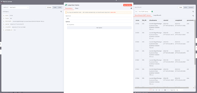

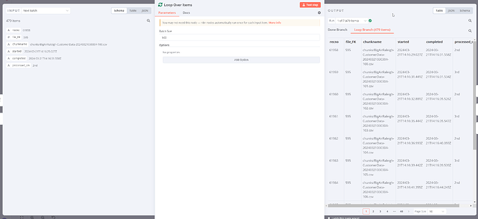

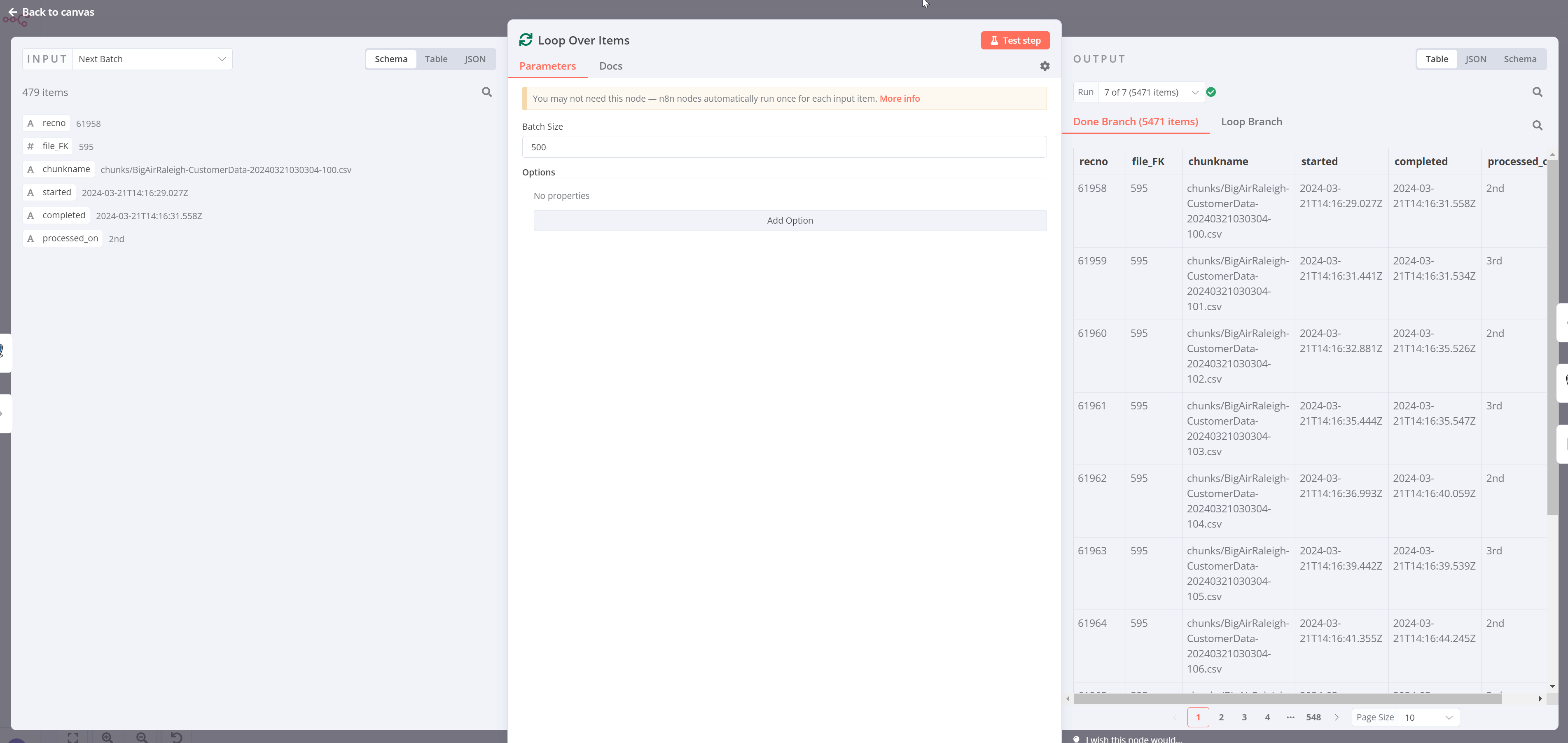

THE PROBLEM HERE IS EXACTLY WHAT I RAN INTO IN MY ORIGINAL POST. That is, once the inner loop thinks that it’s “done”, then when the next batch of input comes in (i.e. the next list of chunks to delete), it just outputs those items to the “done” branch instead of processing them on the loop branch.
As you can see in my screenshots, the items from run 1 went to the Loop branch. Later runs all went to the done branch. I’m not sure if the totals in these 7 runs are cumulative or if I just happen to be processing the files in order of smallest to largest, but the average file is 800-1600 chunks so it’s probably cumulative.
