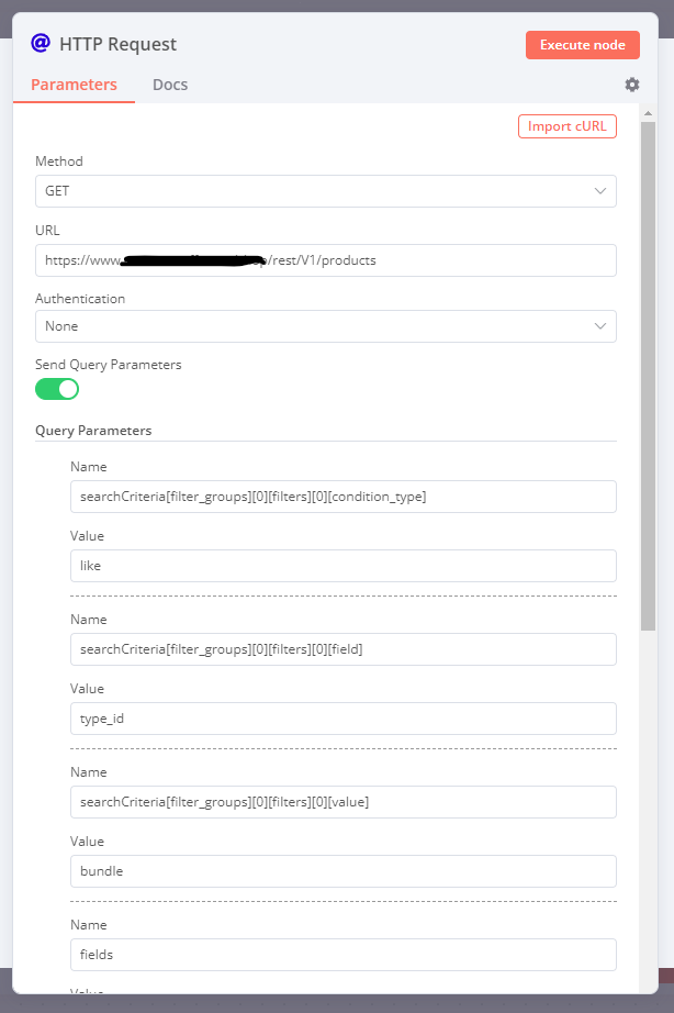

I can successfully use the HTTP request module using bearer authorization (see below).
I’d prefer to not have to hand-craft the API calls (and use the functions built into your Magento node) but if I have to, I have to.

Alright HTTP Request node working is interesting, The credential test calls /rest/default/V1/modules does that same endpoint work ok?
https://www.XXXXX/rest/default/V1/modules fails.
https://www.XXXXX/rest/V1/modules works.
