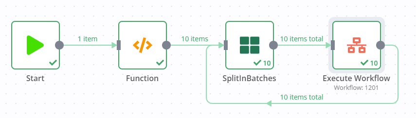

To avoid sending a lot of data to your UI at once (which is what causes the 413) you could use an approach of creating a parent workflow holding very little data itself (maybe just the ranges of each block of 500 items in your Google Sheets). You could then use the Split in Batches node to split this data into batches of 1 and call a sub-workflow through the Execute Workflow node.
In your sub-workflow, process the 500 items and then make sure to clear out any data (e.g. through a Set node executing only once) at the end.
This way n8n would never process more than 500 items at the same time.
Parent Example
Sub Example
In your parent workflow you’d only see a single result for each batch which should be a manageable amount of data:
My example processes only 10 items per batch, but that’s because my example sheet is too small for 500 items per batch
. I hope this nevertheless helps.
