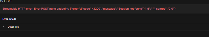

I have connected an MCP server to an AI agent I am using. The MCP server client works great in Claude, ChatGPT, and other services, but n8n seems to be very inconsistent on its connection. I routinely get the following error:
Streamable HTTP error: Error POSTing to endpoint: {“error”:{“code”:-32001,“message”:“Session not found”},“id”:“”,“jsonrpc”:“2.0”}
Anyone have suggestions on how to work around this or is it just not a reliable node in n8n?

the “Session not found” is a known issue with stateful MCP servers and n8n specifically — the MCP client node doesnt persist the session token between requests the way Claude desktop or ChatGPT do, so if the server expects the same session across multiple tool calls it breaks.
two things that help: first check if your MCP server supports stateless mode (some have a flag for it). if not, the SSE transport is generally more stable in n8n than Streamable HTTP for this exact reason — try switching the connection type in the MCP Client Tool node settings.
