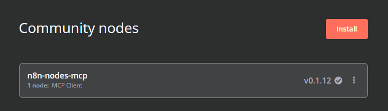

I recently downloaded the new MCP community node.
I have used the node successfully (Brave MCP). I input all the appropriate credentials and everything, just like the example in the community node documentation shows, and it works great.

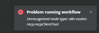

HOWEVER, whenever I try to use it as an agent tool I see this error -
Problem running workflow
Unrecognized node type: n8n-nodes-mcp.mcpClientTool
  • n8n version: 1.82.3
  • Operating system: windows 11

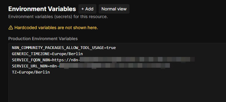

I have the same issue.
I installed N8N on top of Heltzner+Coolify, and I’m not tech-savvy, so I don’t distinguish between Node.js and Docker… yet. Meaning, I need more explained instructions, without coding-skilled assumptions.
My env. variable adde:

@davdelven That looks like Coolify isn’t passing the env variables for you. can you try adding the env variable in the environment: block in the third screenshot?
