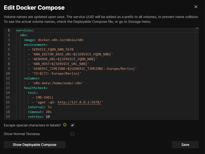

I’m not familiar enough with Coolify.
Maybe add it everywhere. One of the places should work :sweat_smile:

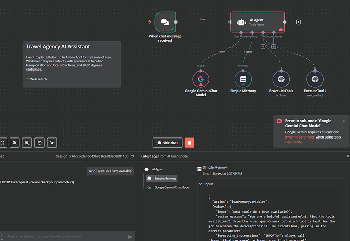

I’m not familiar enough with Gemini either. So, can’t help with that.
Maybe start a new thread for that, and keep this thread for the MCP community node issue.
Here is an existing thread. maybe check there.

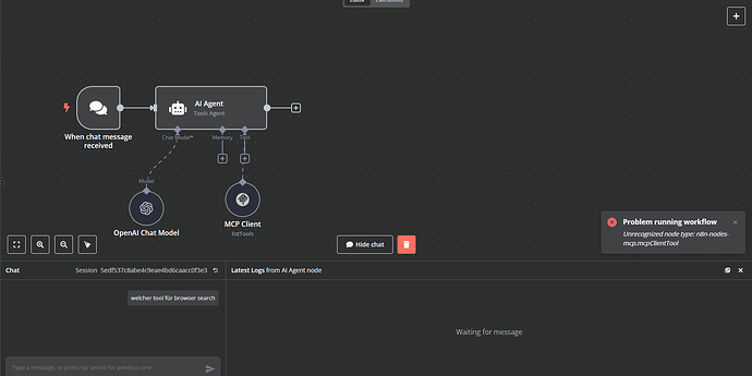

I have the same problem @Anthony_Lee has ( super thanks to bring this up )
Even get the correct result as @netroy suggested ( thank you too ) :
" 0 , [empty], true ". but still get the error on Brave-MCP Tool : Unrecognized node type: n8n-nodes-mcp.mcpClientTool

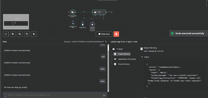

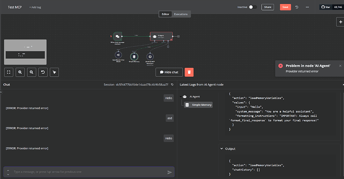

I have this error; Problem in node ‘AI Agent‘ - Provider returned error
(Images) Node MCP Connected
Node MCP Disconected
Do you have the same problem? Thanks!

I had it too and I use coolify to host n8n. in env variables in coolify I set N8N_COMMUNITY_PACKAGES_ALLOW_TOOL_USAGE=true and then tried it again, but it failed. I then went to edit compose file and saw in the env section that N8N_COMMUNITY_PACKAGES_ALLOW_TOOL_USAGE=true wasnt set so i did it myself. After restarting it finally worked out!
