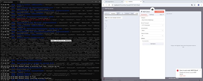

Below the n8n log and the MCP Client configuration:
Notice that even I fill up in the correct way the endpoint in the log it showed with spaces (my white tag in the log).

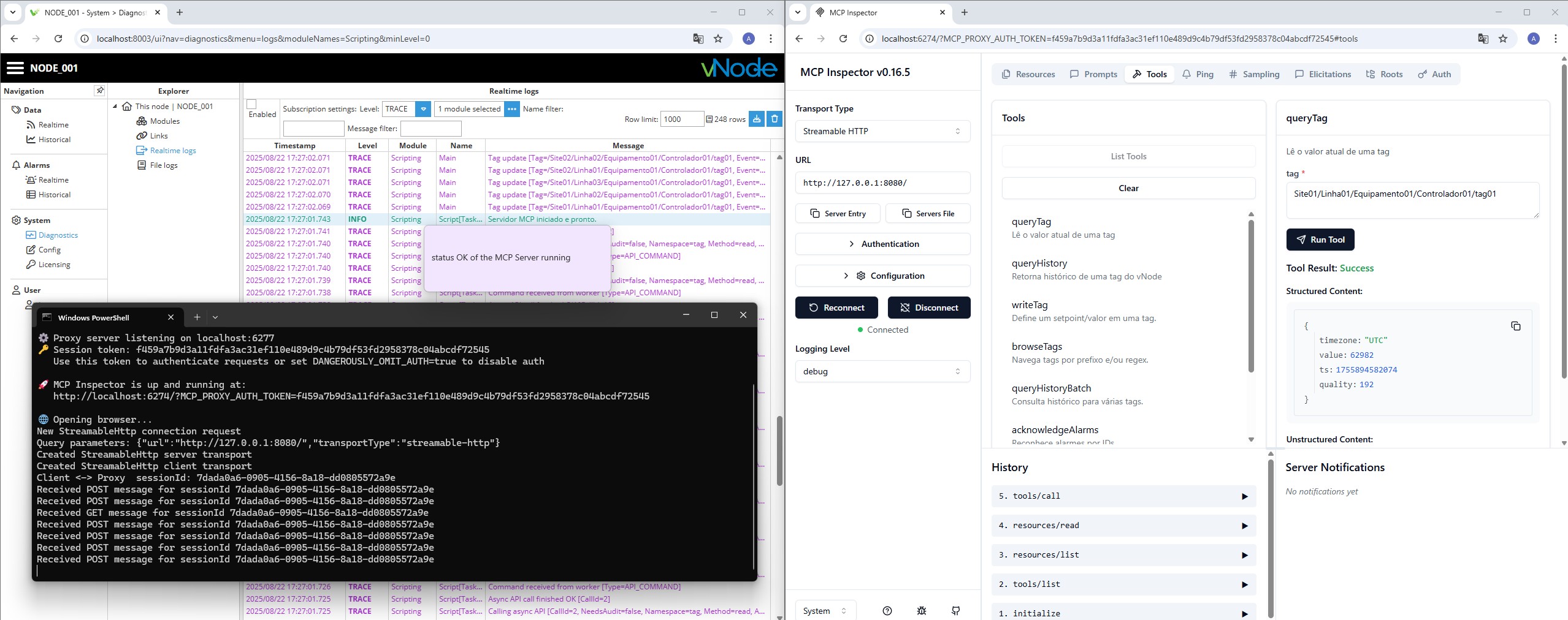

Below the MCP server log and the MCP Inspector working as expected:
I’ve noticed in n8n you use /mcp in the path and in the inspector you do not. Could you try to not use /mcp in n8n as well and see if that helps?
