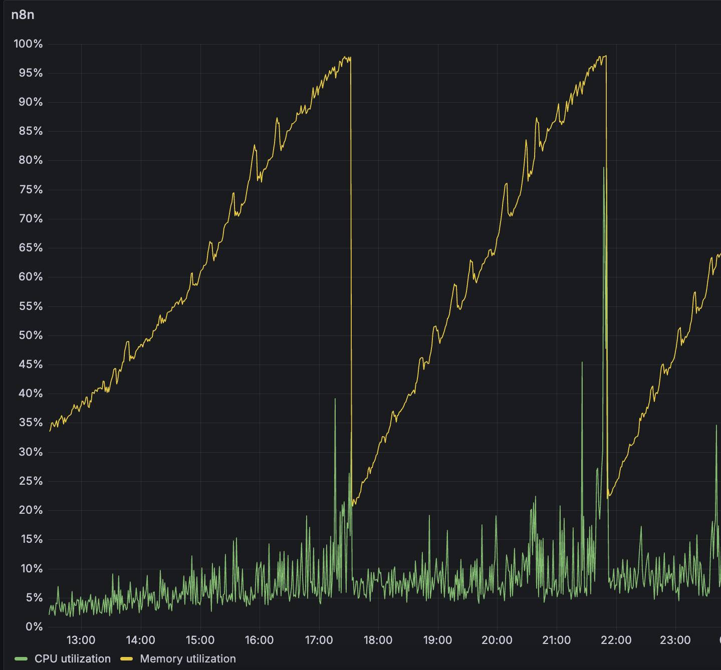

I have a problem with constantly growing RAM utilization until n8n crush and container reload.
My VM: 2 vCPU, 4Gb RAM.

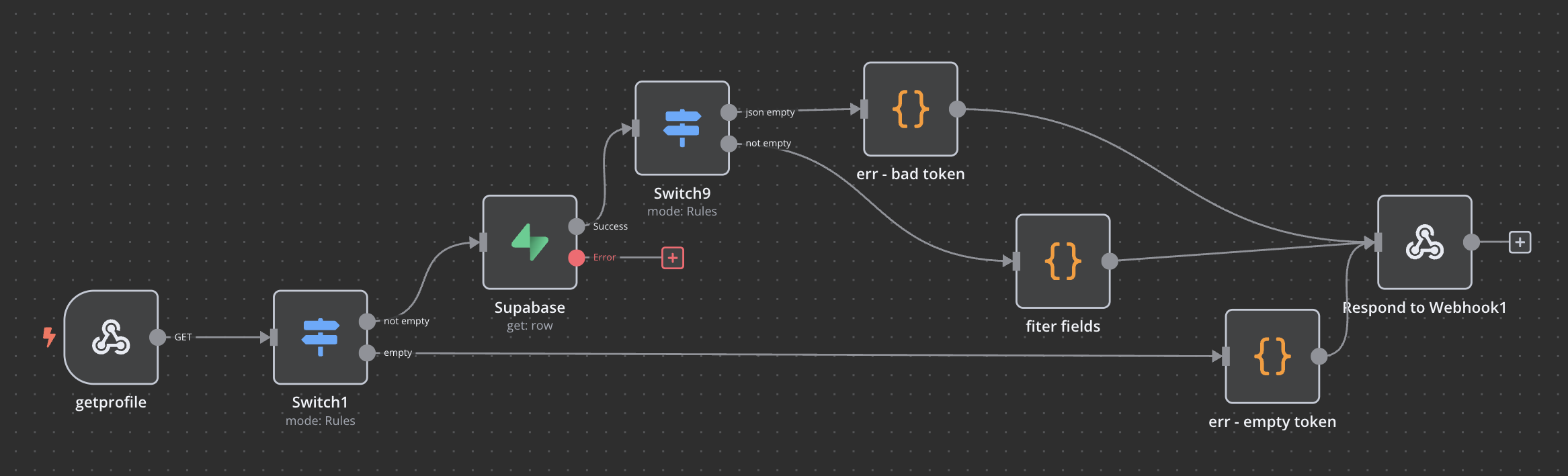

My workflow does not process heavy data but it frequently gets triggered by http requests on webhook.
What workflow does:
  • get one string from DB by token from http request
  • check if token valid or empty
  • filter fields for http response
I know that node “Code” can consume memory but it should not stack in memory forever after workflow got finished and i’m not sure it that node is to blame. So i’m trying to find root cause and solution with your help, guys.

hello @Ivan_Sheev
Welcome to the community! With that pattern is feels something builds up before it breaks and doesn’t seem to be an edge case (e.g. spike event of some sort). Might be worth exploring queue mode: Configuring queue mode | n8n Docs
Are the requests consistent or are you getting bursts from time to time?
