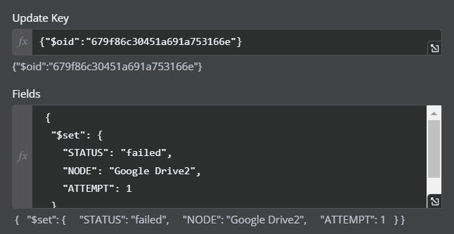

Dogway
February 2, 2025, 7:30pm
4
@lehno is your node still working? I used the BSON syntax at least for the key id (in expression mode)
My data is not being updated, maybe I have to pass the updateOne() function?
"$set": {
"STATUS": "failed",
"NODE": "Google Drive2",
"ATTEMPT": 1
