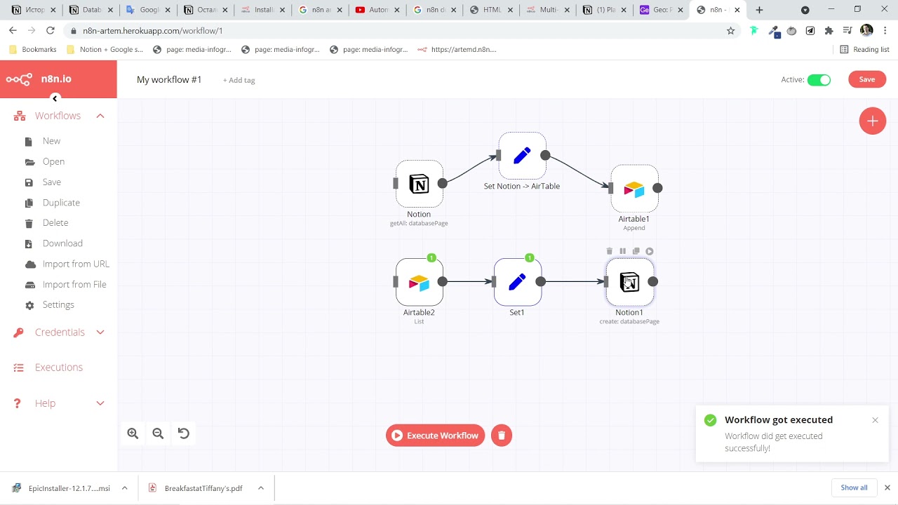

Found out that I can’t send Multi-select Fields from Notion to AirTable. I can see separate select items, but can choose them all and send them as a string with comma separation. Of course, the best choice would be assign Multiple select in AirTable, but n8n doesn’t provide such type.
Is it possible to send all such values as a string?
See the screenshot:

Tnank you. I see, Notion and AirTable interfaces have some differences. For AirTable you only specify the name of fields. For Notion, you specify field names and folrmulas.
After some playing, I managed to transfere selects from Notion to AirTable.
But when I tried to do reverse transition, I faced a type problem. Seems like array is not suitablem and I should “hardpick” the values. When I tried to through an array to a Notion Multi-select field, an error occurs. See the video:
