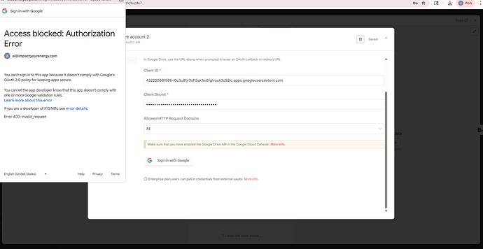

Error 400:Invalid Request. I’m hosting on coolify using docker, and through cloudflare and oracle. 0Auth2 worked fine with the earlier versions. However, google did an update requiring the https:// In front of the 0Auth Redirect so when I paste my URL it doesn’t work anymore. I tried hard coding the URL with an https:// in front and no dice, I also hardcoded it all into my coolify server, no dice. Anyone know how to resolve this? It’s urgent!!

Here’s the full error code URL: https://accounts.google.com/signin/oauth/error?authError=Cg9pbnZhbGlkX3JlcXVlc3QS3gEKWW91IGNhbid0IHNpZ24gaW4gdG8gdGhpcyBhcHAgYmVjYXVzZSBpdCBkb2Vzbid0IGNvbXBseSB3aXRoIEdvb2dsZSdzIE9BdXRoIDIuMCBwb2xpY3kgZm9yIGtlZXBpbmcgYXBwcyBzZWN1cmUuCgpZb3UgY2FuIGxldCB0aGUgYXBwIGRldmVsb3BlciBrbm93IHRoYXQgdGhpcyBhcHAgZG9lc24ndCBjb21wbHkgd2l0aCBvbmUgb3IgbW9yZSBHb29nbGUgdmFsaWRhdGlvbiBydWxlcy4KICAaWWh0dHBzOi8vZGV2ZWxvcGVycy5nb29nbGUuY29tL2lkZW50aXR5L3Byb3RvY29scy9vYXV0aDIvcG9saWNpZXMjc2VjdXJlLXJlc3BvbnNlLWhhbmRsaW5nIJADKkgKDHJlZGlyZWN0X3VyaRI4bjhuLTEwMC5teXF1YW50dW1mbG93LmFpL3Jlc3Qvb2F1dGgyLWNyZWRlbnRpYWwvY2FsbGJhY2s%3D&client_id=432222681988-l0c3u8fjr3sf15sk1m6fglvuuk3c92lc.apps.googleusercontent.com&flowName=GeneralOAuthFlow

This isn’t a Drive node problem and it’s not Coolify specifically either. Google is now blocking the OAuth flow because your app fails the “secure response handling” checks, not just because of https://.
That long error URL you pasted is the key.
What Google is actually rejecting
This part matters:
“doesn’t comply with Google’s OAuth 2.0 policy for keeping apps secure”

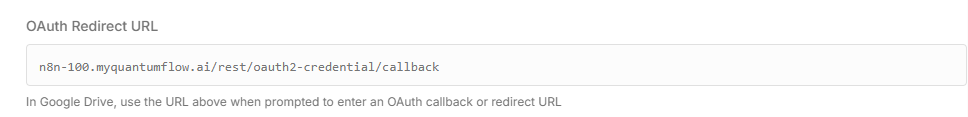

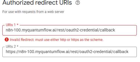

Thank you for your thoughtful response. I implemented all of this, and no dice. Some of these things weren’t updated, so I think I’m getting closer. The deeper I look at it, I’m almost positive it has to do with the image I’ve pasted here. Where my 0Auth Redirect URL is “n8n-100.myquantumflow.ai/rest/oauth2-credntial/callback”. It does not start with the “https://” Then if I hard code it in the google oauth it still pulls from what I just gave here, as the error code reflects. Any other ideas of why this is happening and how to fix? I’ve been talking with chatgpt for hours and we cannot get it solved haha.

Also in Google, don’t forget to always include the https:// with your n8n instance domain,
This should be all you need @Quantum_Jake Let me know if this works..
