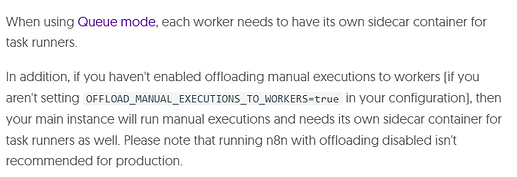

I think you can set N8N_RUNNERS_ENABLED=true on your main instance just to satisfy the deprecation warning,
you already using OFFLOAD_MANUAL_EXECUTIONS_TO_WORKERS=true so i think you won’t need the task runner for the main instance.
Read this part from docs
