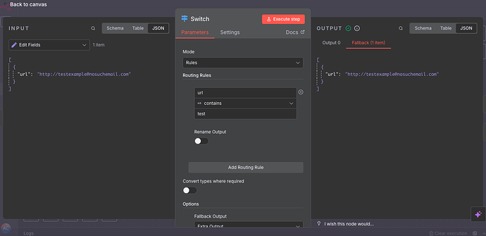

The Switch node does not correctly match simple “starts with” or “contains” rules against string fields, always sending items to the Fallback output—even when the field value obviously matches the rule. This occurs even in a minimal workflow with clearly defined string values.

3. Add a Switch node:
  • Mode: Rules
  • Routing rule:
    • Field: url
    • Condition: starts with
    • Value: http

Actual Result
  • The item always goes to the Fallback output, regardless of input.
  • The problem also occurs with the “contains” condition, and with obvious string matches (e.g. url: 'https://...', rule: “starts with https”).

Workflow Setup:
Edit Fields Node:
Switch Node Parameters and Output:

Hey @AndyC24uk hope all is well. Can you share the workflow itself instead of a screenshot, as it looks like this works for me just fine. (although I am testing on self-hosted version)
Thanks @jabbson! Here is the workflow.
The problem is here:
it should be not url, it should be {{ $json.url }} and the field needs to be an expression.
This output is not activated because the text url and the text http://testexample@nosuchemail.com and not equal.
Fantastic! That solved it! Thanks!
