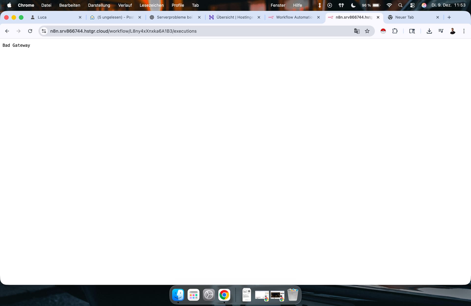

  • n8n Editor takes minutes to load (“Loading… / Redirecting…”)
  • Sometimes returns 502 Bad Gateway
  • Container restarts frequently

The issue seems to be a combination of Node.js memory limits and proxy configuration. First, try increasing Node.js heap size by setting `NODE_OPTIONS=–max-old-space-size=8192` in your Docker environment variables. For the Traefik proxy error, add `N8N_TRUST_PROXY=true` to enable `trust proxy` in Express. Also, consider switching from SQLite to Postgres if you’re running many active workflows, as SQLite can become a bottleneck under heavy load.
