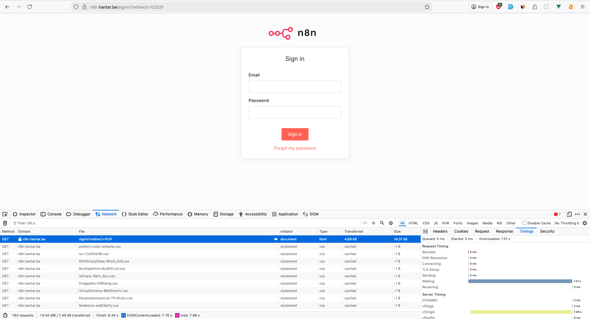

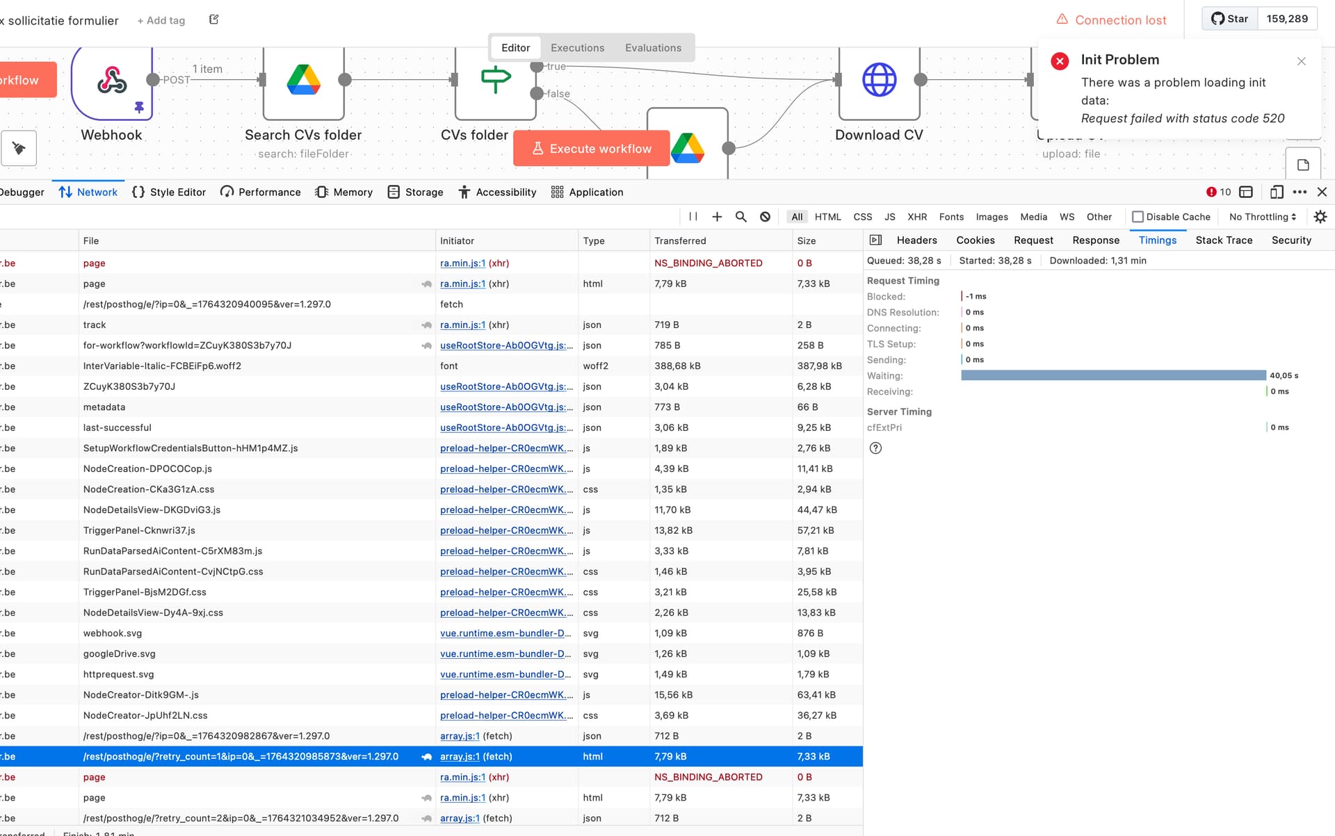

New selfhosted n8n instance is very slow with 1 basic workflow
I installed n8n about a week ago to try it out. But I still not have used it properly because it is very slow. Just the login screen takes 20-30 seconds. Then trying to open a workflow also takes about 30 seconds. The strange thing is, I have dedicated enough resources to it (even overkilled it, see section below information on n8n setup)

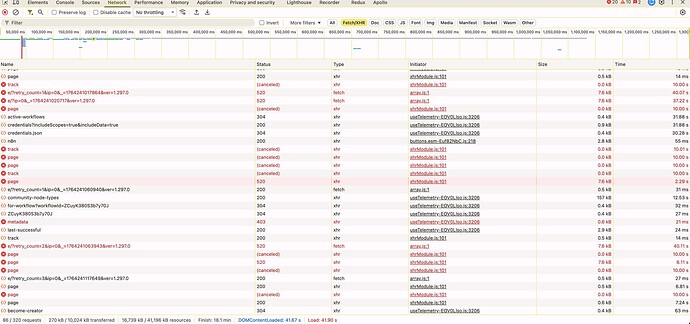

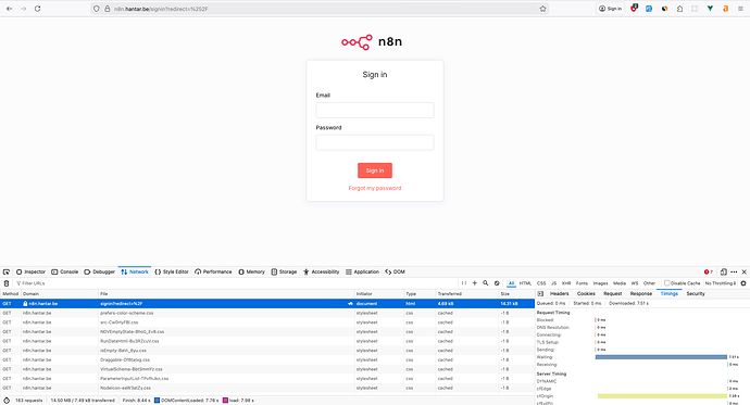

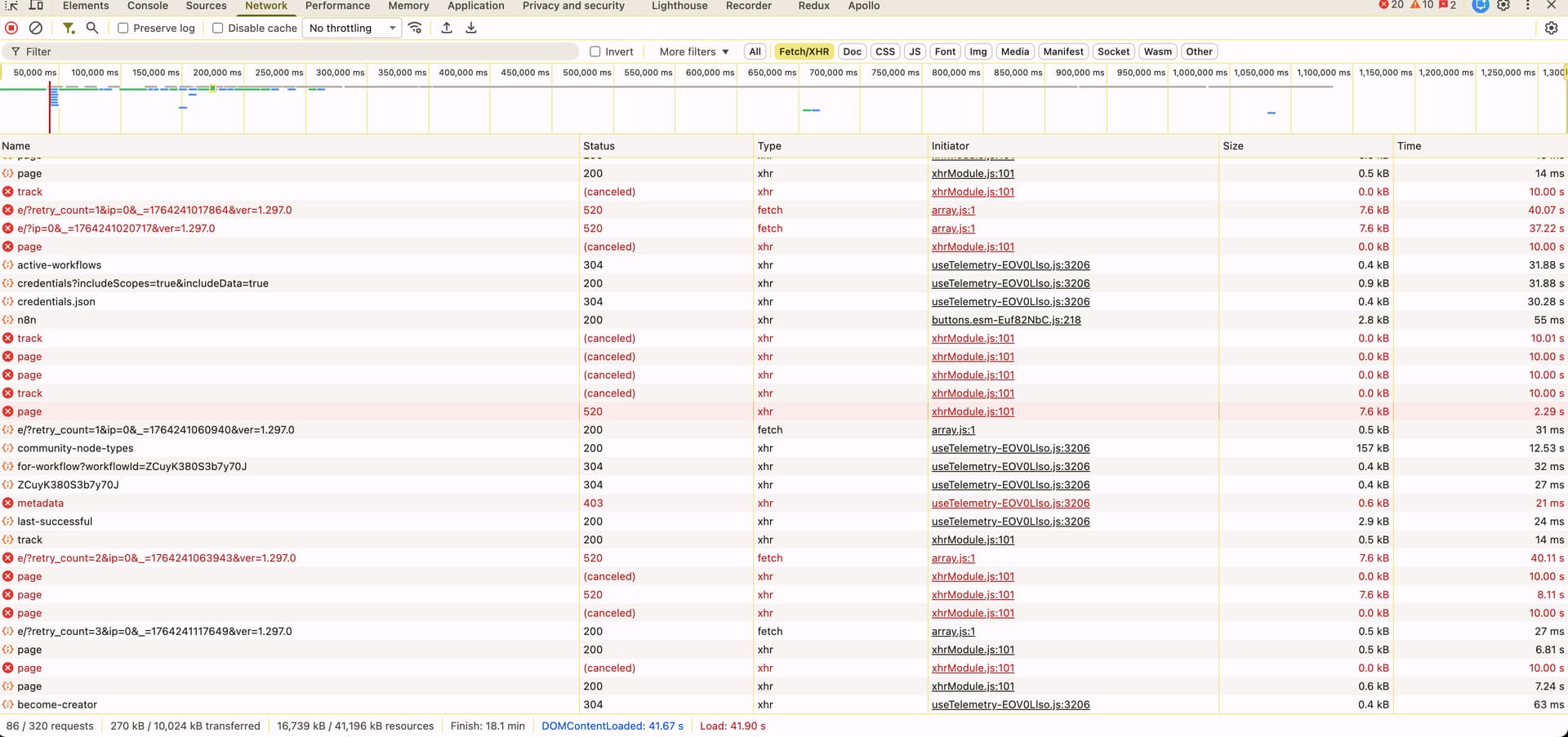

I do see in the network tab that a lot of requests are being cancelled or returning 520

Hi @appunitsai
I also tried in firefox and it is the same there.
Today I got the 520 as a notification in the UI of n8n. I don’t know if I am getting it because n8n is having problems or if it is due to my reverse proxy now?
To find out you can just disable the reverse proxy and access n8n directly via localhost..
If it works normally, then we’ve identified that the proxy is the problem.
Another thing to check is the database. You can use SQLite for now just to test.
In short, you can set up a simple, clean installation without any proxies or extra configurations..
Once everything is working correctly, start adding the services one by one, that way if a problem appears, it will be easier to identify where it comes from.
Can you increase the resources a bit (just for testing)? I honestly think it’s because the resources, you are running docker + images with just 2GB of RAM which could lead to such slowness, I’m suggesting if you don’t want to waste money on server resources, that you run all the setup locally with the same resources that you have mentioned and see if you are experimenting slowness then that’s the issue for sure.
Okay! I have been testing locally through my local ip address then it is working just fine without any issues!
Then the problem should be with traefik or cloudflare. However double checking the config it all seems just fine. Maybe I am overlooking something. Will report back when I have more details.
