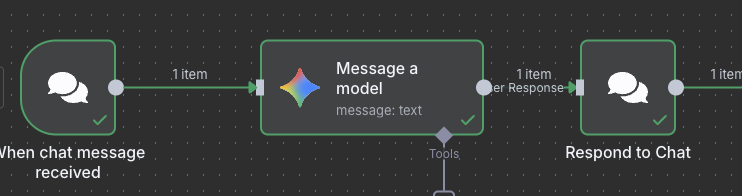

Hey! I tested this on my end and the bubbles will stay active until the AI response is printed in the chat:
Could you maybe record a quick video of this behavior on your end so I can get a better idea of whether it’s expected or not? Make sure to also include the nodes in the video if you do, so I can see how they fire in time.
