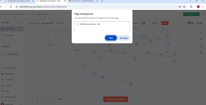

I’m facing an issue with my self-hosted n8n setup (running in Docker). For the past week, my instance has become very slow and unresponsive.
  • Whenever I open any node in a workflow, it takes a long time to load (10–15 seconds), and after that the browser becomes unresponsive and shows the “Wait” or “Page Unresponsive” dialog.
  • Because of this, I’m unable to debug or even change a single line in my workflows.

I just opened the workflow after changing the environment variable and restarting the Docker container.
Now, when I try to open Telegram or any other node, it throws an error saying “unresponsive, waiting, or exited.”
The issue is still the same. I also tried using the n8n Cloud free version, but it still gives me this error sometimes.
