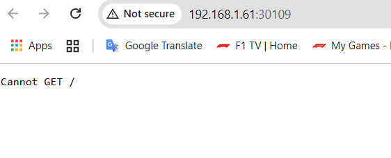

n8n web UI error:
Cannot GET /
any ideas what could cause the problem? I’m also very new to everything so be nice.

ok I added debug logs here:
but the app still doesnt work even if it looks like it deploys, this is what you get from the web UI:

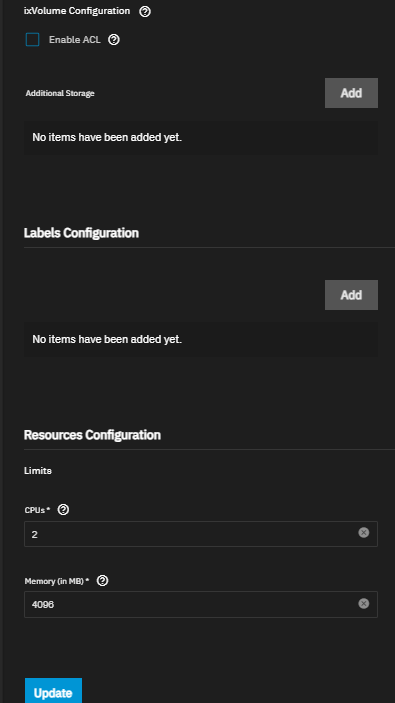

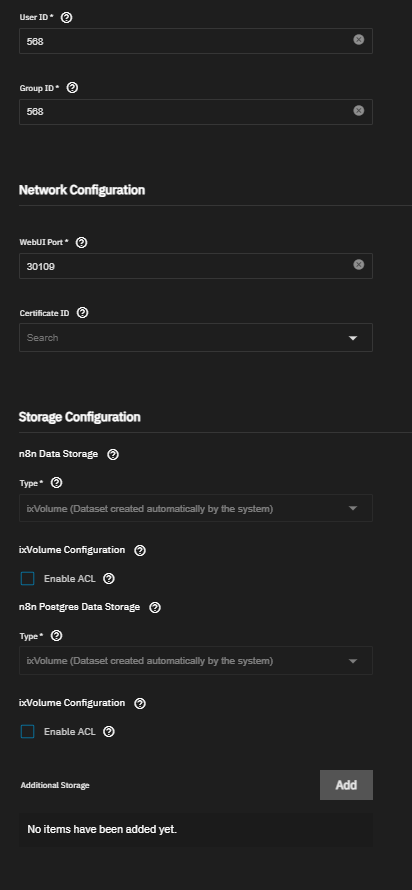

And can you show the docker config for the n8n?
again its not really config as you think of, its an app on truenas so I can show you the app config
