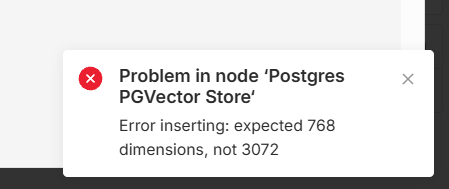

Thank you for your prompt response. If I create a table with embedding vector (768), then I’m unable to store the pdf into the vector database. I’m getting the attached error during PG Store. I believe the output dimension is hardcoded to the default 3072 within the n8n nodes for the models/gemini-embedding–001 . I unable to store my pdf in the vector database with vector(768)>

Looking at your error screenshot, it confirms what’s happening: the embedding model is outputting 3072 dimensions but your table expects 768. So the model itself is definitely producing 3072-dim vectors regardless of what the n8n UI says the “default” should be. Your table at 3072 was actually correct for storage, the retrieval issue is probably a config mismatch somewhere in the agent setup. For text-embedding-005 if you want to try that route, Google’s docs say it outputs 768 dimensions by default so that should work with a 768 table, just make sure you use the same model for both store and retrieve.
