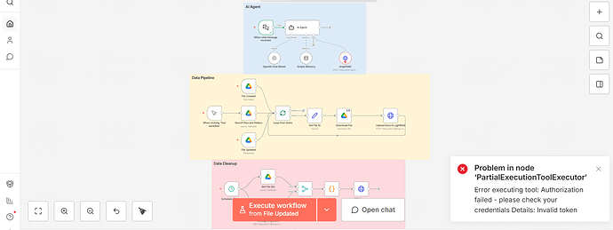

THis is the exact workflow. I’m running into an “Invalid token” error in n8n, even though the authentication setup and token have been verified on the backend.
Error: Problem in node ‘PartialExecutionToolExecutor’
Error executing tool: Authorization failed – please check your credentials
Details: Invalid token
What’s confusing is that this setup was working perfectly before with no changes to the API or credentials.
Here’s what I’ve checked:
  • Backend authentication method and token validation are correctly configured
  • The token itself is valid and works when tested directly
  • Auth headers are correct and unchanged
  • Same setup previously executed without issues
This makes it seem like the issue isn’t the token itself, but something in the execution path that’s affecting how the token is being passed or resolved, especially when the tool runs through PartialExecutionToolExecutor.
Has anyone encountered a situation where:
  • A previously working setup suddenly reports “Invalid token”?
  • A valid token fails only in certain execution contexts?
  • Tool execution changes how credentials are injected?
Any insight into what could cause this would really help.
Thanks.
This is expected behavior in n8n v2.x when an AI Tool is executed via PartialExecutionToolExecutor (step execution). In that execution path, credentials are not reliably loaded/injected, so the HTTP Request Tool ends up sending no auth header (or an unresolved one), which surfaces as “No credentials provided” or “Invalid token” even though the token is valid.
Fix / workaround i think will help you out:
  • Don’t use the legacy HTTP Request Tool for authenticated calls
  • Use a regular HTTP Request node inside a separate workflow
  • Call it via Execute Workflow Tool (or run the agent via full execution)
Alternative:
  • Manually set the Authorization header (env var / static token) instead of relying on credentials injection.
So the token isn’t actually bad, it’s the tool execution context in v2 that’s dropping credentials.
