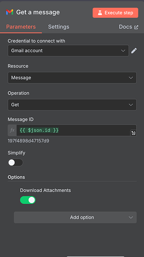

I’ m using V1.001.2 cloud service and trying to get attachment data from gmail node, such as gmail trigger / get massage of gmail. But I cannot get attachment data even setting OFF on “simplify” field.
It would be highly appreciated, should some one can advise how to get the attachment data.

Hi, Did you try add Options
Then turn on Download Attachments yet?
Thank you very much for your advice, “Add option” does have “Download attachment”! Much appreciated!
