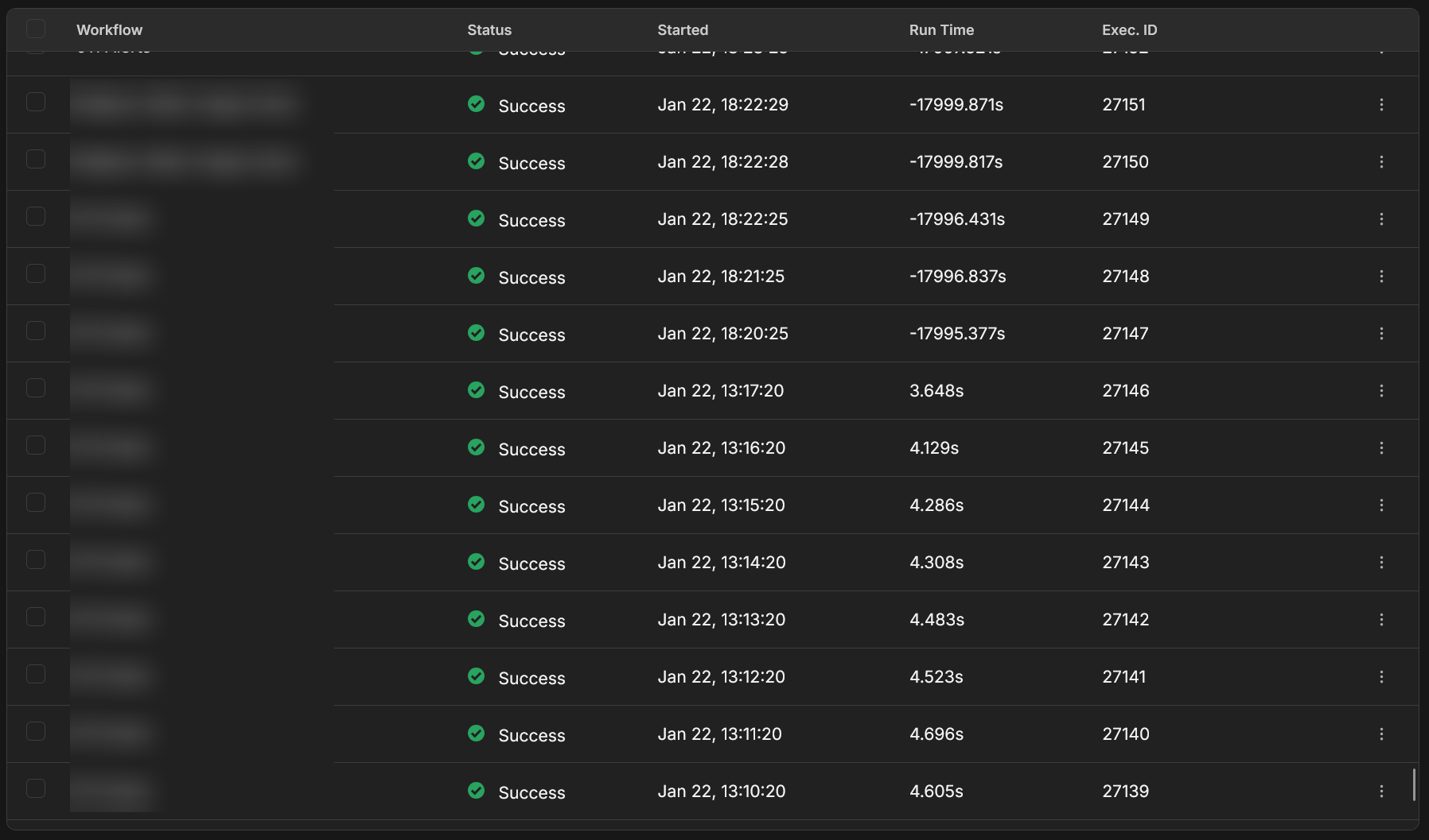

I’m running n8n self-hosted through TrueNAS and after updating it to the latest version (2.5.1), n8n seems to have lost track of time..? The update/creation times for my workflows are correct, but the Execution Run Times are very negative numbers, even though they’re still running fine.

After looking at the execution list more closely, this doesn’t appear to be a workflow or performance issue.
The key detail is that the negative runtimes are very consistent at about -18,000 seconds, which is almost exactly 5 hours. There’s also a clear cutover point in time: executions earlier in the day have normal runtimes (3–5 seconds), and executions after that point suddenly show large negative values.

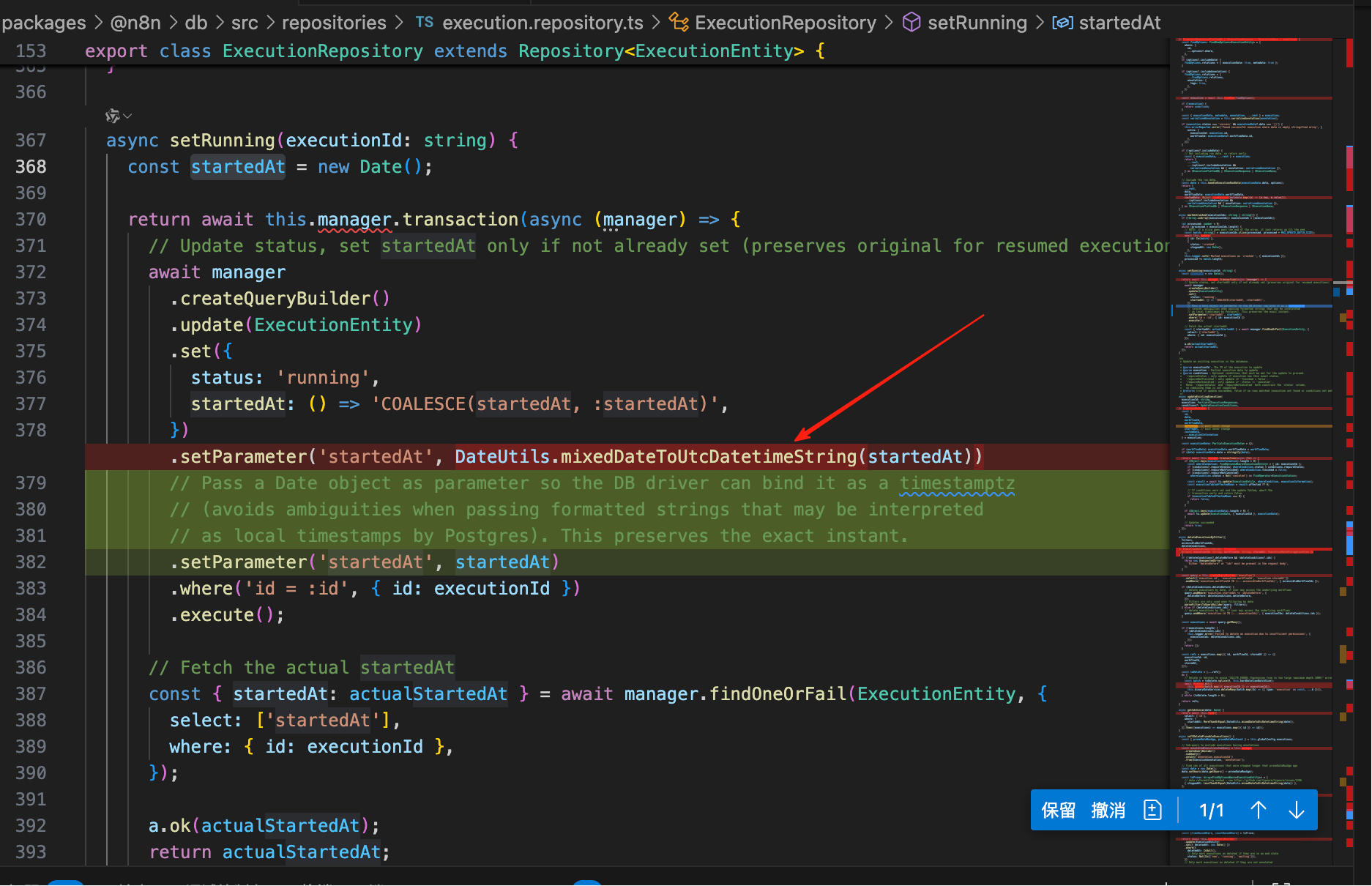

coming back to this post as i’ve just seen a PR on the n8n GitHub that appears to acnowledge and offer a solution to the problem we ran into. seems like it’s Postgres specific, but it was a breaking change included in 2.5.0. here’s the link if you’d like to follow along with any (hopefully quick) progress:

This issue stems from the use of the mixedDateToUtcDatetimeString function to format the AT time starting from version 2.6.4.

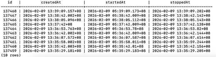

The timestamps in the database are all messed up:
