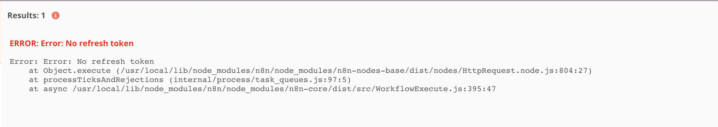

Unfortunately, it never worked. I have reset and re-input the credentials and recreated the app on the Shopify side. On first run it errors with ‘No Refresh Token’.

It seems that it authenticates fine. The window pops up and I can press the accept button. n8n seems to think it is connected, but when an action is executed it throws the No Refresh Token error.
