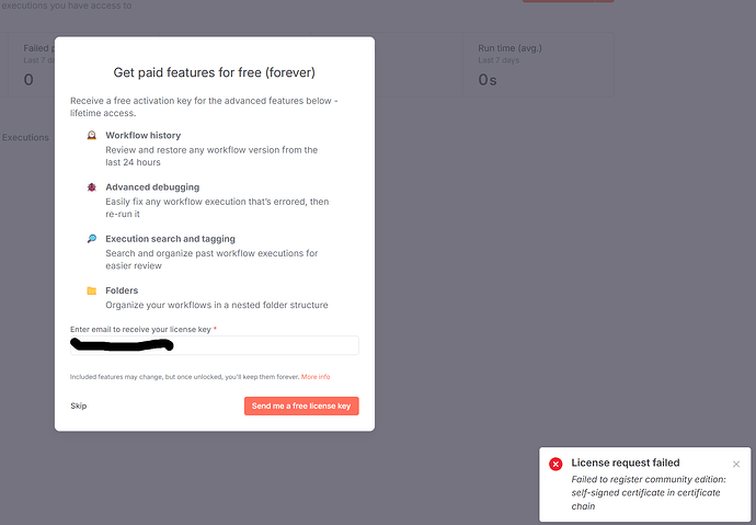

Not Able to register community Edition
400 Failed to register community edition: self-signed certificate in certificate chain and similar issue facing when i am trying to use what’s app trigger provide client id and client secret. I have loaclly hosted n8n

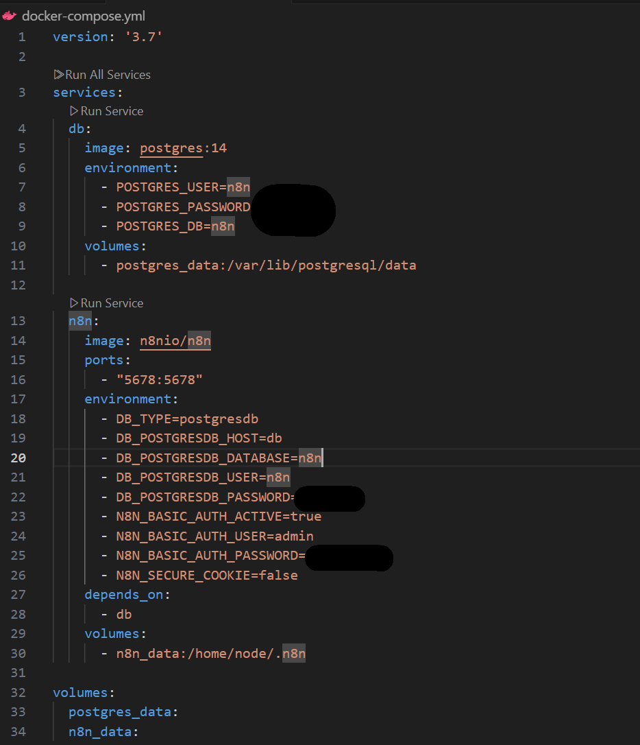

no you can see my docker compose file
Also it is happening on send me free license page as well as any step when i am executing

replied in above post . I have hosted it locally on a docker instance with http not https though i had previously had tried with https
I am able to solve the problem you can skip this issue now sinc i am using for local dev I used
- NODE_TLS_REJECT_UNAUTHORIZED=0 flag to skip making a https call to any external servies
