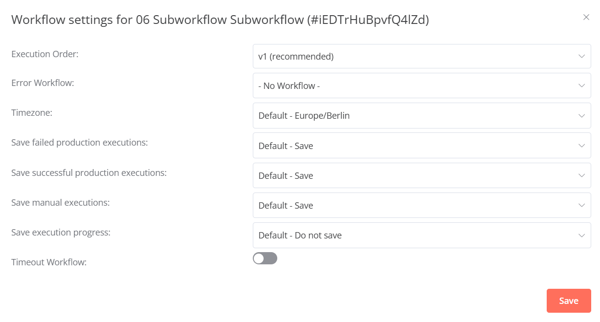

Hi,
sorry for asking a silly question.
I followed this guide to build a sub-workflow: Sub-workflow
There is no option in the workflow settings

Every workflow can be used a sub-workflow.
See the example.
The execute a workflow as sub-workflow you simply add the When Executed by Another Workflow trigger, define parameters, …
Hi Franz,
that helps me a lot and it’s working fine.
Maybe the documentation is a bit misleading
