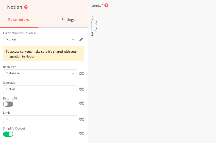

So I tested it as you mentioned above. It works a bit strange. For example, it works if I want to get a list of all users:
But if I want to get a list of databases it doesn’t work at all:
Hey @mnardit,
Have you added your integration to your Notion database? If you go to the Share link on the top right of any database or page you can then add the integration you made to it which will allow it to see the data.
Thank you! It works perfect now.
