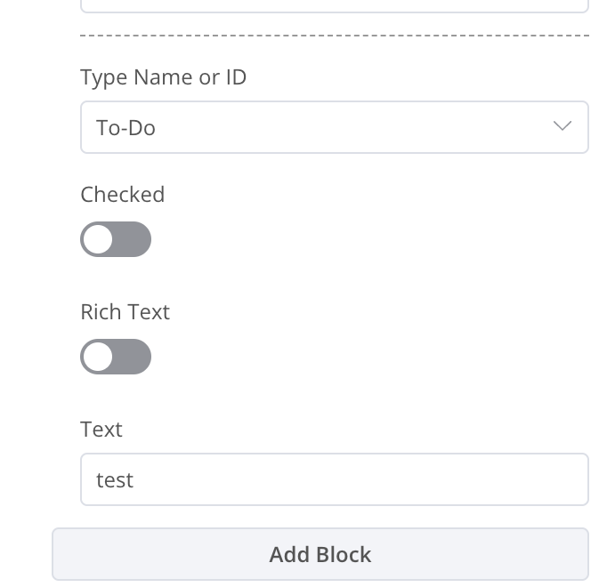

Notion Error : body failed validation: body.children[5].to_do.rich_text should be defined
I’m creating an entry in the database. The entry create successfully with multiple blocks defined. When trying to define a “To-Do” block I get the below error. I’ve tried both with the “Rich Text” toggled, and without.
400 - {“object”:“error”,“status”:400,“code”:“validation_error”,“message”:“body failed validation: body.children[5].to_do.rich_text should be defined, instead was undefined.”,“request_id”:“4defc105-0c1a-44ad-a731-882e6c081ce1”} - body failed validation: body.children[5].to_do.rich_text should be defined, instead was undefined.
this is in n8n cloud.

I don’t think it is, if I remove the “to do” block, the action runs fine. If I add a to-do block that has no reference to any other data just a simple text message of “test123” it fails, if the box is empty if fails, if it has reference to any other external data it fails. The gyst is , no matter what way I try to create a “to do” block in notion it fails with the rich body error.
Hi @dylan :wave: Thanks for going into a little bit more detail - that gave me enough information to test :smiley:
It looks like this is indeed a bug with the Notion node and the To Do block, I’m afraid. I’ve let our engineering team know about this, and I’ll be back when I have any updates!
