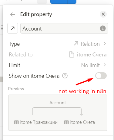

If a Notion Relation property is one-way, it is not found in Notion nodes (filters, add page, update page).
Once you add a backward relation, the property appears.
The bad news are that two-way relations are sometimes must be avoided as it may result in thousands of items slowing down DB.
Screenshots
This is the Notion part

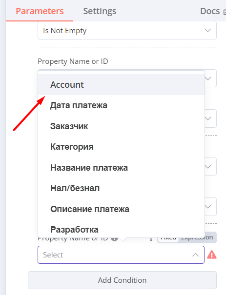

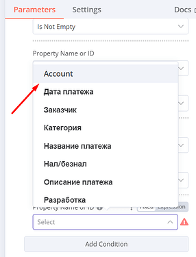

This is the n8n part, using Notion filters. The Account property is visible ONLY if I enable the Show on toggle above.
