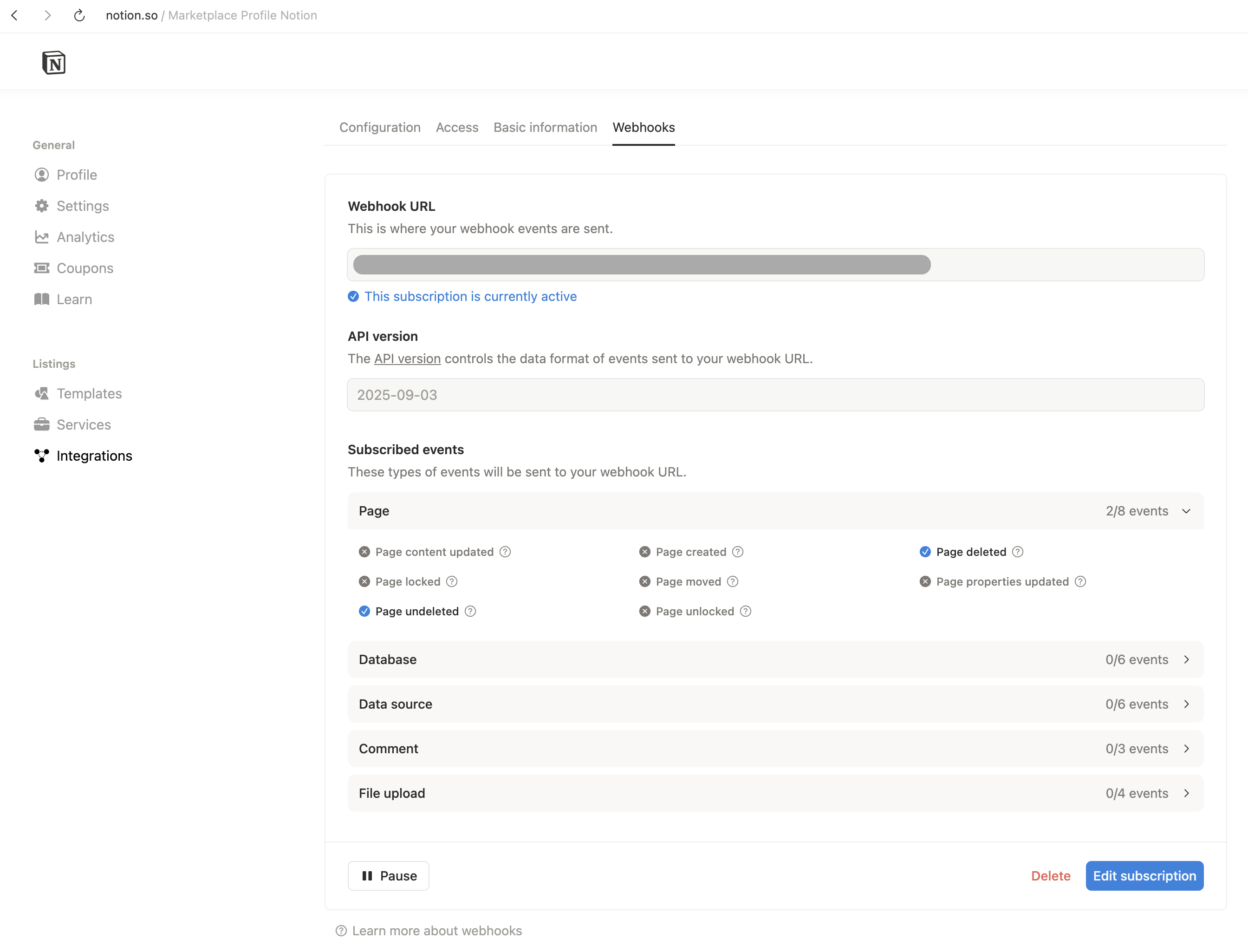

I encountered the same issue, but found a work around by using a webhook. I made a webhook on the Notion integration page and set it to trigger on page delete. In n8n i made a webhook trigger node, set it to POST and authenticated the link back in Notion. When a page in Notion gets deleted it triggers n8n to receive the deleted page’s id and you could work from there!
This approach is working. Thank you @mordo
