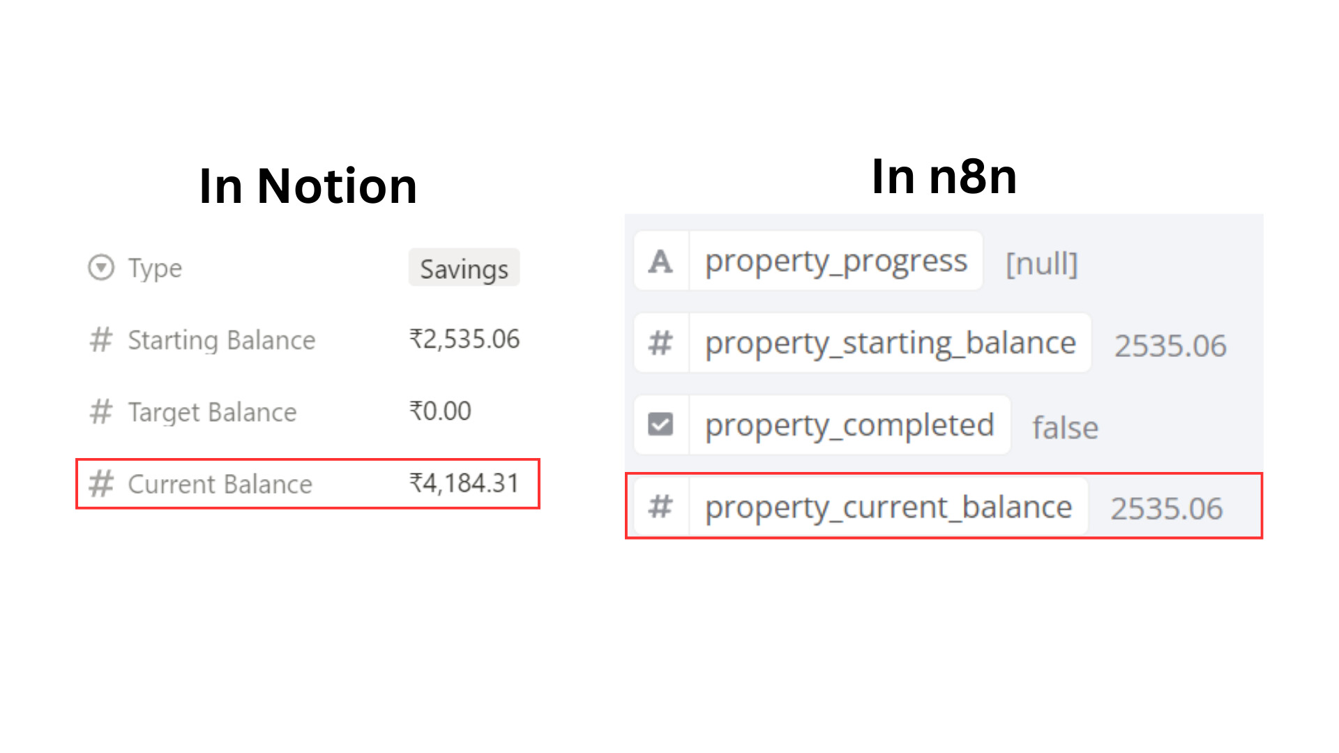

But, the values that we get from Notion are not correct, for many formula fields. I am presenting a single example here, as it is the most crucial.
The property is named “Current Balance”. The formula for that is:
The values are being displayed properly in Notion. But, in n8n, if I try to fetch the page from the database, it shows only the “Starting Balance” property’s value. Attaching a screenshot for reference:

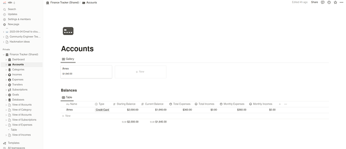

Hi @Jayavel, I am sorry you’re having trouble. I tried reproducing this with a simplified data structure using this formula in Notion:
n8n is, however, showing the right result for me:
Can you confirm where the fields in your Notion database not shown on your screenshot live (Total Incomes, Total Expenses, Total Transfer-In, Total Transfer-Out), how you’ve configured each of them and which value each of these has?

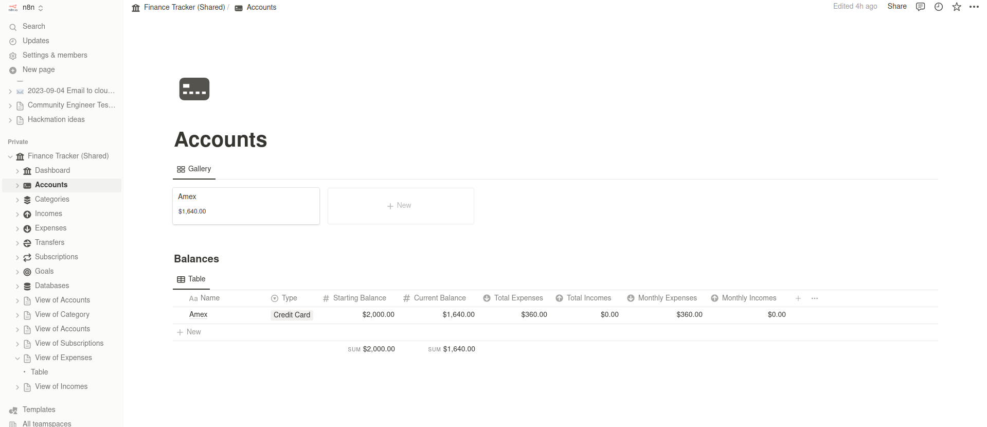

Hi @Jayavel, thanks for sharing your Notion template!
It doesn’t seem to include any data currently, can you tell me exactly what I need to add to your example and which database page I need to fetch in order to see the problem?
In that template, you have to start by adding an “Account” and filling in the ‘Starting Balance’ and record some expenses.
The ‘Accounts’ is a database and any entry you add to that will become a Database Page. So, if you add Amex as an Account and fill in $2000 as the opening balance, you can then record some expenses which will automatically update the “Current Balance” property.
After this, if you pull this account’s data in n8n, it should show the Opening and Current balance.
Now, you can add more accounts and check for each entry, if you get the correct ‘Current Balance’ value.
