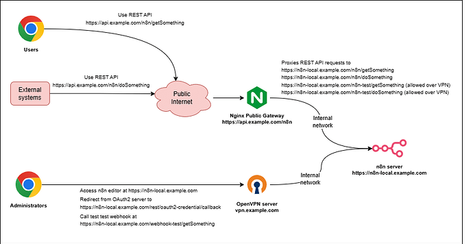

Let’s see how n8n should be configured to make the default OAuth2 redirect URI work:
  1. You run n8n on the internal machine available over VPN.
  2. n8n UI is available at https://n8n-local.example.com only to the administrator.
  3. Your DNS server resolves:
  4. n8n deployment environment variables and endpoints environment variables should be configured like this:
  5. n8n uses N8N_EDITOR_BASE_UR and N8N_ENDPOINT_REST to generate default OAuth2 Redirect URI as https://n8n-local.example.com/rest/oauth2-credential/callback
  6. n8n generates production webhook URLs using WEBHOOK_URL and N8N_ENDPOINT_WEBHOOK as https://api.example.com/n8n/getSomething
  7. n8n production webhooks are proxied via reverse proxy and publicly available at https://api.example.com/n8n.
  8. n8n generates test webhook URLs using WEBHOOK_URL and N8N_ENDPOINT_WEBHOOK_TEST as https://api.example.com/webhook-test/getSomething
Here is how I deployed n8n and secured it:
It would be handy if n8n allowed to change webhook-tests separately via WEBHOOK_TEST_URL but it’s not possible. So you have to change api.example.com to n8n-local.example.com in the case above to access the test versions of the webhooks.
