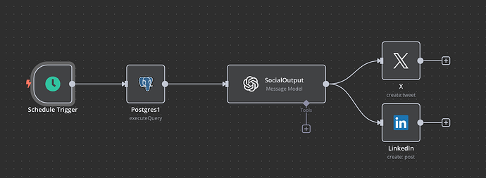

Hello, I am getting the [Object] [Object] error when using AI to write social content for me.
As you can see, simply the trigger gets a random article from my DB, which is fed into AI (ChatGPT) and then outputted to X and Linked in.
However, the outputs return random json strings, as you can see here…
I was wondering if there is a way to use a function to lock the output, like in excel when you use $, to lock a formula… how do I get a constant return of the data?

It would be insightful if you could pin some critical data to understand its structure and post the workflow using the </> button. It would make attempts to help here out less of a guesswork.
Here is how: Google sheet: data is replaced in the existing row instead of adding new row - #8 by Olek
If you want to avoid things like [undefined] appear when a specific field is only occasionally present in the output you can use expressions like {{ messages.content.whatever ?? ""}}. This will efectively add "" when a data point is not available.
[Object Object] appears when you try to put an object (a structure with fields) into a context where a string expected. This how Javascript deals with those situations. The good point to start is to use expressions like {{ JSON.stringify(data.field.whateverObject) }} to understand the structure, problem and if the output with special characters in it is deemed better than having nothing (i.e. [Object object]).
You may also want to use the Structured Output Parser node/tool:
If you find anything above helpful, please mark this post as a :white_check_mark: Solution.
Thank you, I have added a set node before the social outputs. I have tested it, and it seems to have worked. I will leave it a few hours to do it’s thing as sometimes the output works a few times then switches up.
