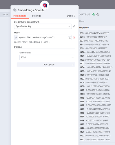

I support this idea. As a temporary workaround, you can use the OpenAI Embeddings node, provide your OpenRouter API key, and set the Base URL to https://openrouter.ai/api/v
The workaround not working for me. Still need a openrouter embedding node for solution.
This workaround does not seem to work for me either. Although I’m using https://openrouter.ai/api/v1/embeddings as my base URL (and can see available embeddings models correctly), I end up receiving a MODEL_NOT_FOUND error (which seems to originate from the underlying LangChain library).

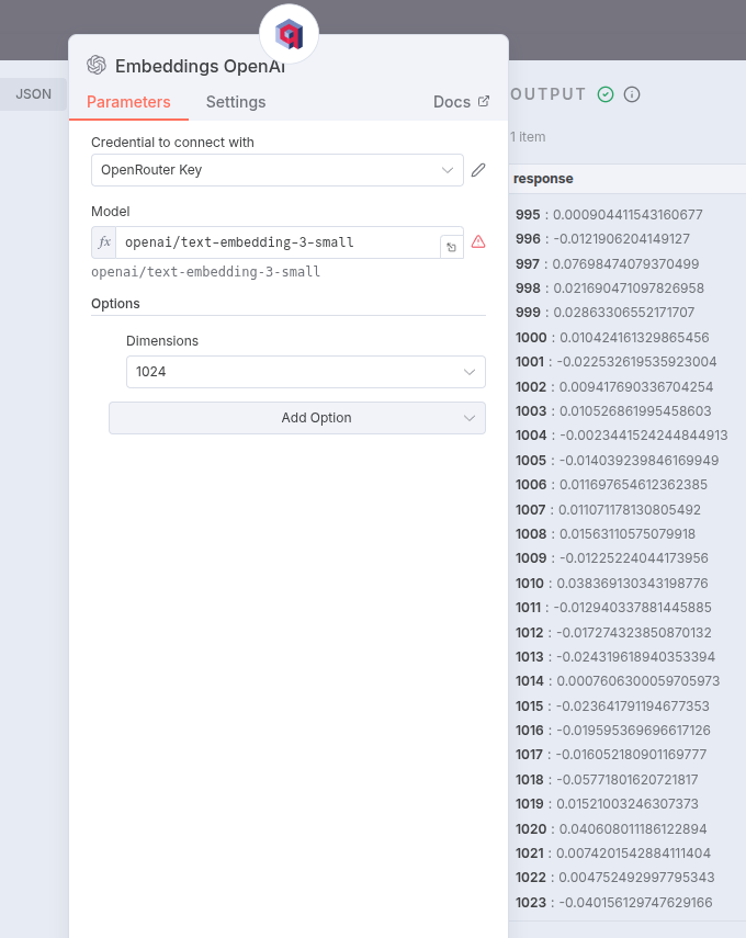

It works when you strip the endpoint back to https://openrouter.ai/api/v1 even if you loose visually comfortable ability to select an embedding model from the drop-down list. Instead after that you have to specify the desired embedding model manually (as expression, in my case “openai/text-embedding-3-small”) and here you go.
Try set endpoint https://openrouter.ai/api/v1 and specify the desired embedding model manually
