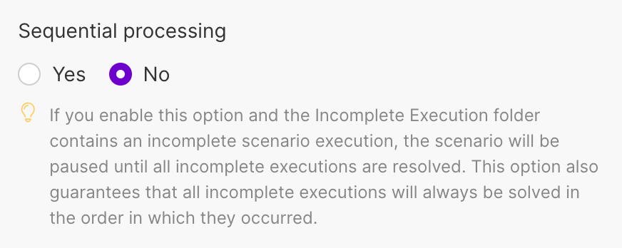

Yep, moving from Integromat to n8n and having to find work-arounds for this. We have two critical workflows that we must guarantee are not run twice for the same items.
It should be a workflow setting with an option to either save oncoming triggers in a queue or refuse execution.
