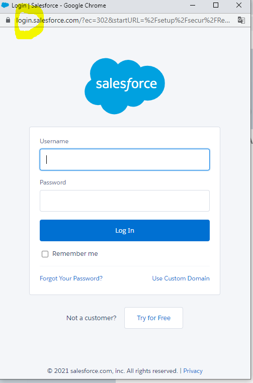

Did this PR actually fix the issue? I still am directed to login.salesforce.com to authenticate via OAuth2 when ā€˜Sandbox’ is selected as environment type.
I still see the issue. No one in SF does dev on production, so adding this option can do wonders :slight_smile:
Currently facing this issue also — the Salesforce Sandbox OAuth in n8n Cloud still redirects to login.salesforce.com instead of test.salesforce.com. An update on whether this has been resolved, or a recommended workaround for Cloud users, would be appreciated.
