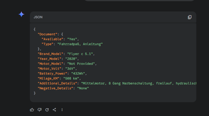

Result:
    "Document": {
      "Available": "Yes",
      "Type": "Fahrradpaß, Anleitung"
    "Brand_Model": "Flyer c 5.1",
    "Year_Model": "2020",
    "Motor_Model": "Not Provided",
    "Motor_Volt": "36V",
    "Battery_Power": "432Wh",
    "Milage_KM": "508 km",
    "Additional_Details": "Mittelmotor, 8 Gang Narbenschaltung, freilauf, hydraulische Felgenbremsen v.+hi., Schiebehilfe, Berganfahrhilfe, Felgenschloß",
    "Negative_Details": "None."

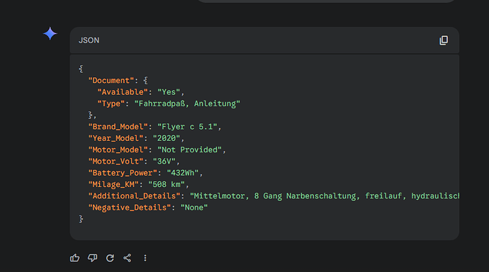

Same test result on UI too:

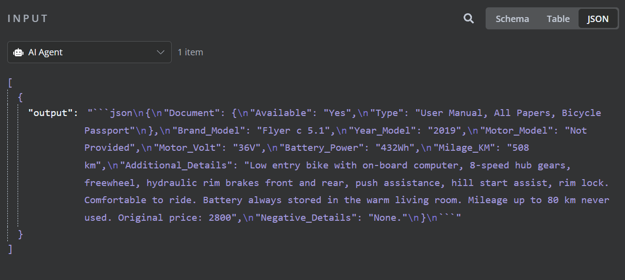

Problem probably you are not cleaning up json format. Because AI returns this:
  "response": {
    "generations": [
          "text": "```json\n{\n\"Document\": {\n\"Available\": \"Yes\",\n\"Type\": \"User Manual, All Papers, Bicycle Passport\"\n},\n\"Brand_Model\": \"Flyer c 5.1\",\n\"Year_Model\": \"2019\",\n\"Motor_Model\": \"Not Provided\",\n\"Motor_Volt\": \"36V\",\n\"Battery_Power\": \"432Wh\",\n\"Milage_KM\": \"508 km\",\n\"Additional_Details\": \"Low entry bike with on-board computer, 8-speed hub gears, freewheel, hydraulic rim brakes front and rear, push assistance, hill start assist, rim lock. Comfortable to ride. Battery always stored in the warm living room. Mileage up to 80 km never used. Original price: 2800\",\n\"Negative_Details\": \"None.\"\n}\n```",
          "generationInfo": {
            "finishReason": "STOP"
  "tokenUsageEstimate": {
    "completionTokens": 164,
    "promptTokens": 978,
    "totalTokens": 1142
NOTE:
My perspective is that let the AI generate JSON format and respons should be only the JSON format like my example, then try to extract that json from “text” (you can see above json AI return) with cleaning extras with code (like JS that I provided above)
If my reply solves your problem, please remember to mark it as a solution.

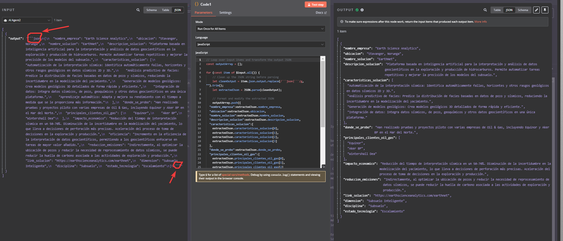

Your parser didn’t work because n8n not able to parse it. Use this one:

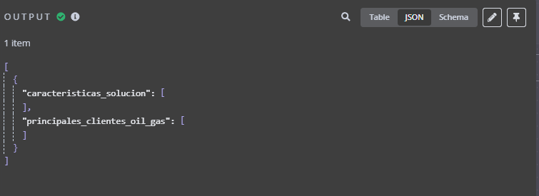

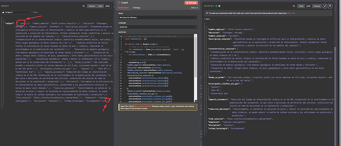

Hi, Thanks for the help. I run the code you mention but it din’t work. I modify one of the arrays and use the function slice() but also didn’t work.
Here’s the code i run.
// Loop over input items and transform the output JSON
const outputArray = [];
for (const item of $input.all()) {
    // Clean up the JSON string before parsing
    let cleanOutput = item.json.output.replace(/```json|```/g, "").trim();
    let extractedJson = JSON.parse(cleanOutput);
    // Format and modify the extracted JSON
    outputArray.push({
        "nombre_empresa": extractedJson.nombre_empresa,
        "ubicacion": extractedJson.ubicacion,
        "nombre_solucion": extractedJson.nombre_solucion,
        "descripcion_solucion": extractedJson.descripcion_solucion,
        "caracteristicas_solucion": extractedJson.caracteristicas_solucion ? extractedJson.caracteristicas_solucion.slice(0, 4) : [],
        "donde_se_probo": extractedJson.donde_se_probo,
        "principales_clientes_oil_gas": extractedJson.principales_clientes_oil_gas ? extractedJson.principales_clientes_oil_gas.slice(0, 3) : [],
        "impacto_economico": extractedJson.impacto_economico,
        "reduccion_emisiones": extractedJson.reduccion_emisiones,
        "link_solucion": extractedJson.link_solucion,
        "dimension": extractedJson.dimension,
        "disciplina": extractedJson.disciplina,
        "estado_tecnologia": extractedJson.estado_tecnologia
return outputArray;

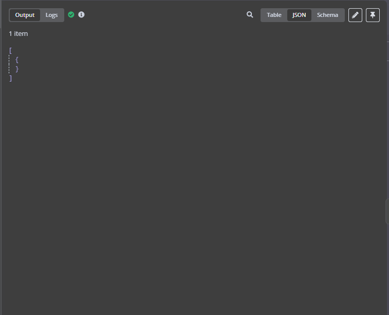

Here’s the output:
I’m frustrated with this. It should be simple to work.
Also, when you said that din’t work for n8n. Why? Is it something on their side? Is the Gemini model? I would like to underestand so I can know what to do in future workflows. Thanks for the help!
I used what you provided. I tested same input couple times and it was working. I only changed Gemini 2.0 Flash and also created that JS code. Never failed me.
Why it is not working on n8n: Gemini’s response needs to be parsed. n8n parse not able to get json format properly, I guess because of extras at the beginning of json response.
If you tested with different input, make sure 2nd agent responds expected json properly. If that is returning properly, make sure your JS file alligns with response. What I mean, each key name and if it is array their values amount like what you done with slice needs to match.
My guess is currently you are not able to get proper output from 2nd agent. It might be changed by Gemini. If your key names always same and getting proper output, then problem is parser.

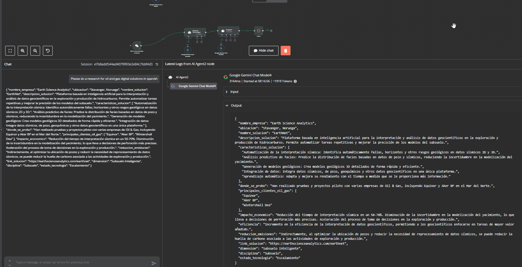

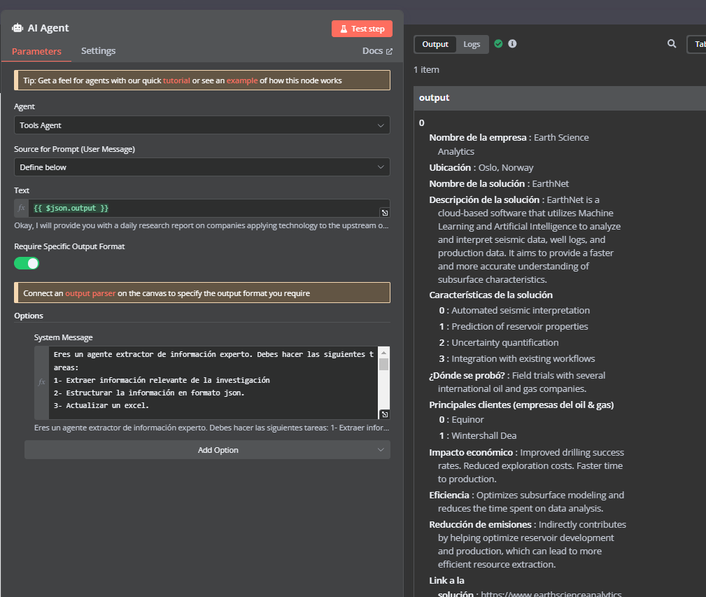

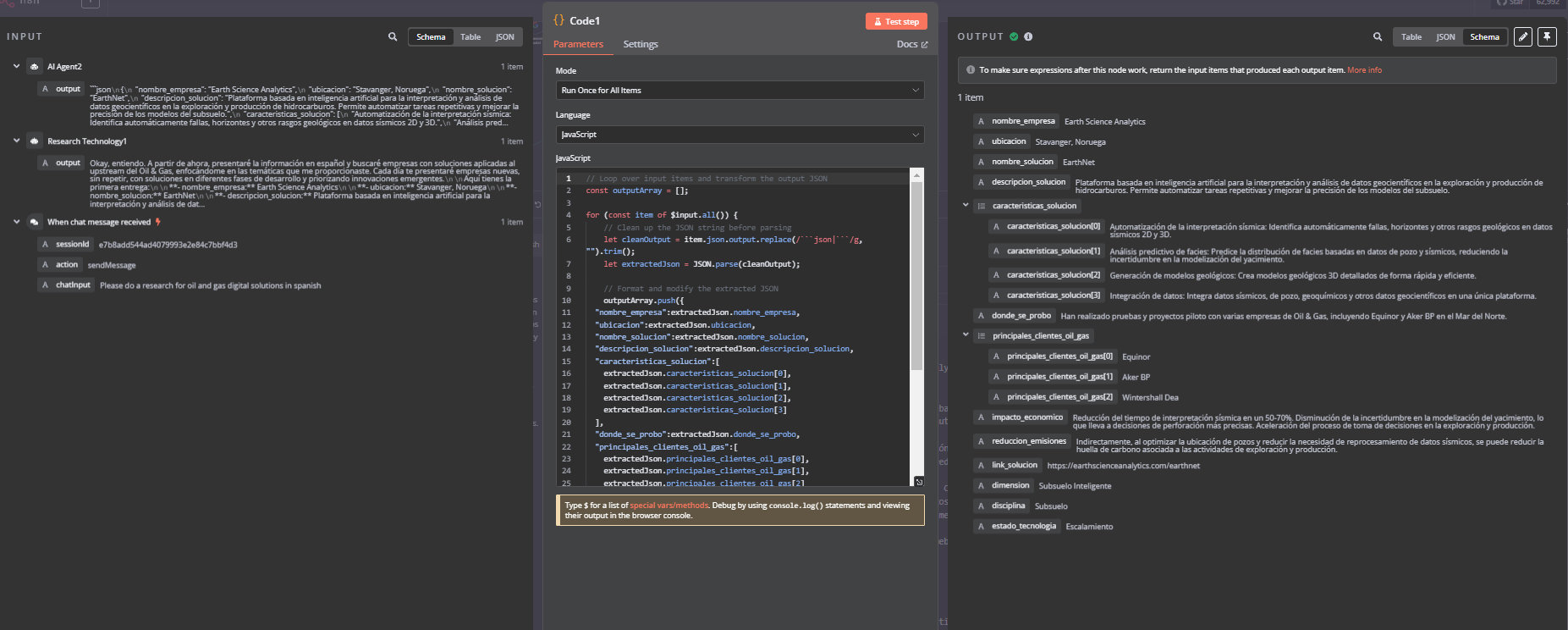

Also:
Can you please check what are you using in second agent model.
This is what I used in 2nd one:
This is first one:
This is example result for second agent response:
This is after json parser:
This red markeds are the problem: (didn’t marked all but you got the idea)
