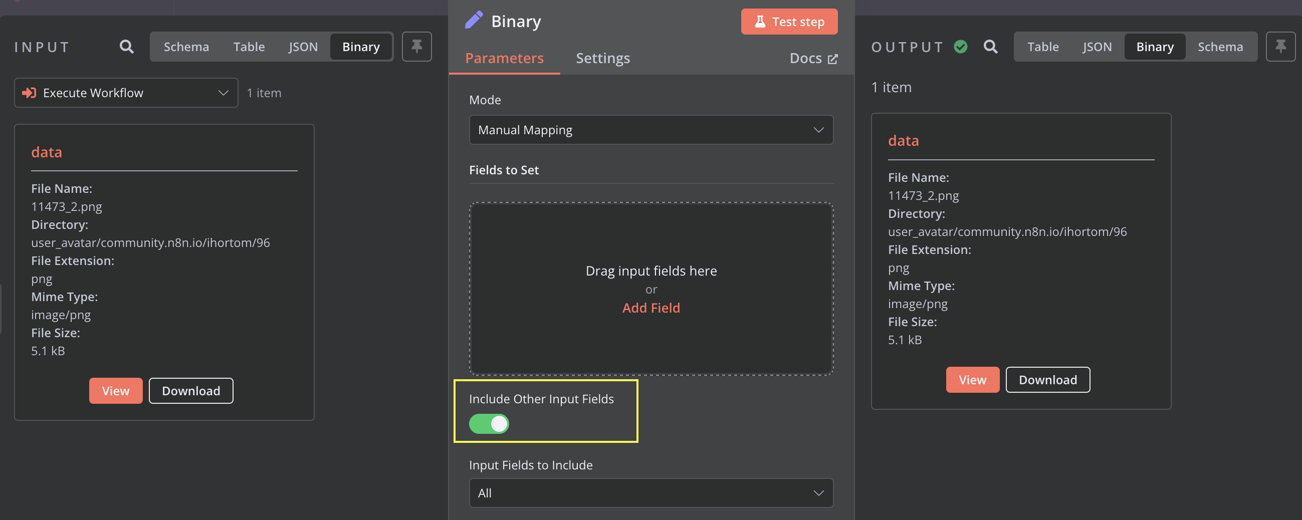

Hey @LucBerge , if the node that has the binary is immediately preceding the node you want to access it then you should be able to do it. If it does not work for you that likely means you are not doing it right.
Reading your original post I realized that you are trying to pass the binary between workflows, not the nodes and the post I mentioned does not give an example of this specific use case. However, it does work and I didn’t think a special demo needed.
Try running the below workflow to see how passing the binary from child workflow to the parent works (do update the workflow ID to see the demo in action).
Here’s how binary file (“Binary” node) looks like. I used Set node to demonstrate it where the important option to note is “Include Other Input Fields”.
