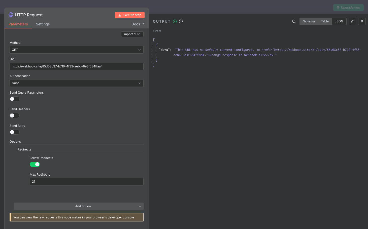

Hi @Ricardo_Castro_Llore,
I tried setting up a similar HTTP Request node and I’m pretty sure mine worked:
Note the url I’m using is the same you provided: https://webhook.site/85d08c37-b719-4f33-aebb-8e3f584ffaa4
When I Execute step, the output I get is:
“data”: “This URL has no default content configured. <a href="``https://webhook.site/#!/edit/85d08c37-b719-4f33-aebb-8e3f584ffaa4\”``>Change response in Webhook.site."

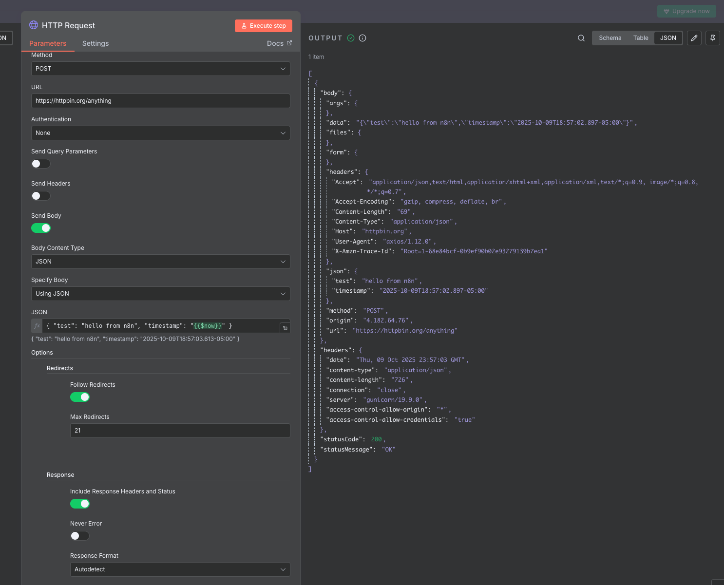

Could you try a different URL such as https://httpbin.org/anything and do a POST Method, with a tiny JSON body content type, Specify Body: Using JSON and add:
{ "test": "hello from n8n", "timestamp": "{{$now}}" }
Then see if that works for you when you Execute?
