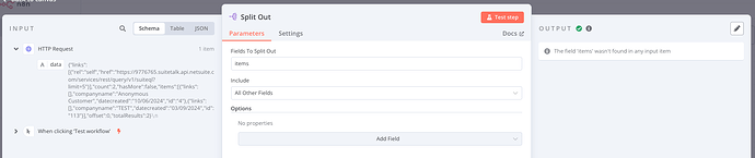

I have created a web request and getting back a non conventional json.
N8N comes back with only 1 node called data
I need to loop through the items part in that json.
to eventually create a task in clickup where i need company name in the task description.
I tried multiple options but not able to achieve that.

@Menno
You can use ‘split out’ node and pass ‘Items’ to it. This would give you desired output and then you can loop around those items.

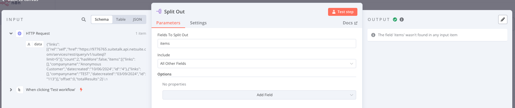

Menno
November 6, 2024, 6:40am
4
Hi,
Thanks for the response. Have tried this, but is not working.
@Menno ,
You need parse it first since api response is in string.
Use code node after your https node as below example shows that it first parse the string.
Menno
November 6, 2024, 9:59am
6
Thanks for the help. That solved my problem.
