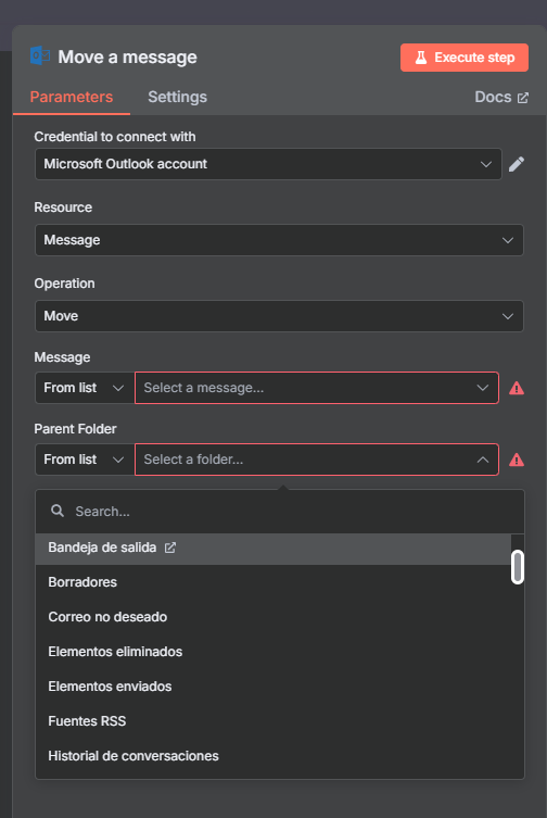

Good I have a problem with the list of my folders in the mail, I have about 100 folders and subfolders to derive the mails.
The problem is that in the node mo “move message” in the section “From list” I only list 50, is there any solution to list all the folders I have?
This is the node:

What if you start typing the name of the folder you are looking for in the search field? Would it come up?

No, I tried to do it but it doesn’t detect the folders I need either.
