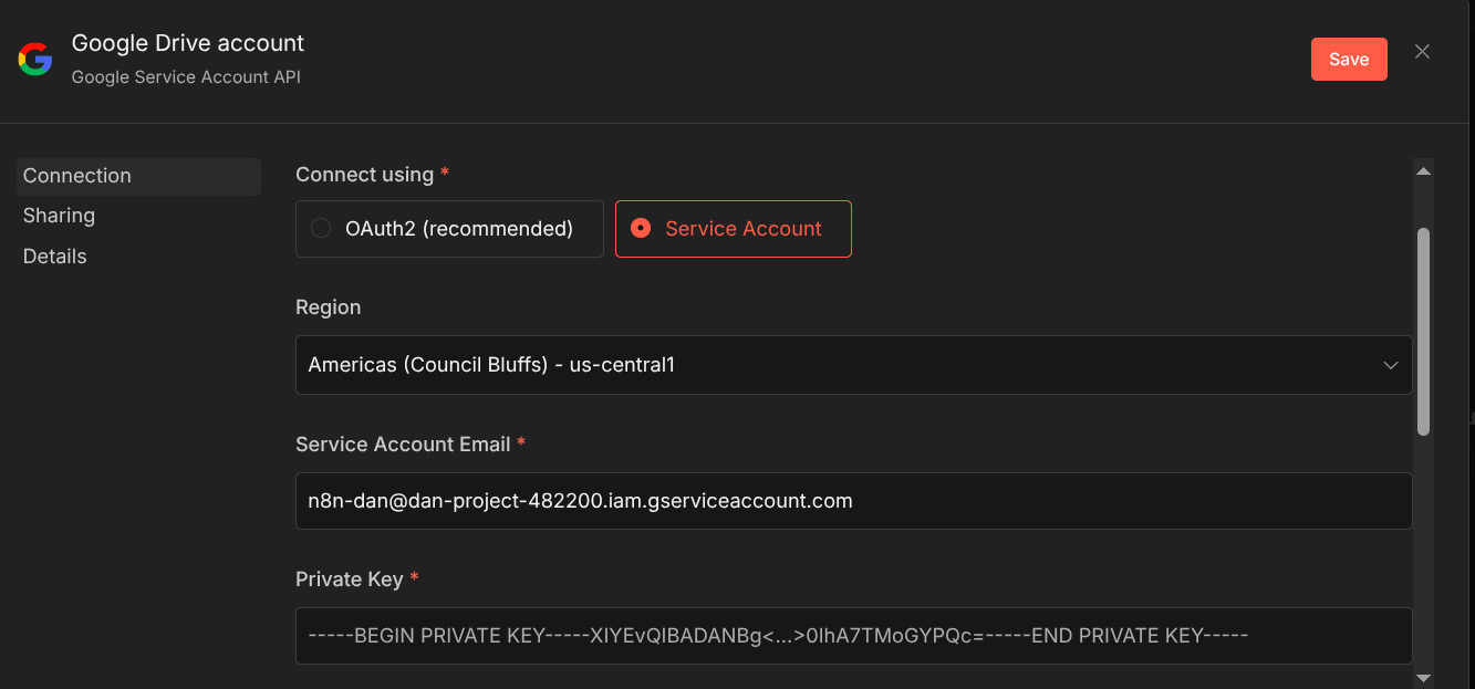

Hey man. I had the exact same problem and my solution was to create a service account in google console, and just use it for my google nodes (for me specifically it was Drive). No matter what I tried, the auth just didnt work. im actually glad to see its not just me.
Anyway, go create a google service account. If you’re struggling I’ll add some SC of how i did it & linked to n8n

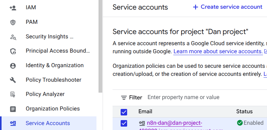

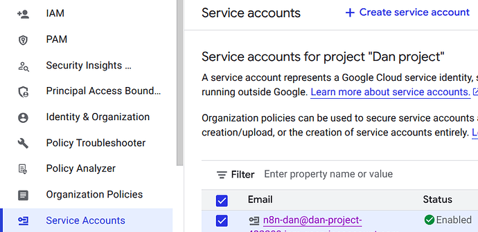

Pick Credentials (I’m assuming you know how to get here)
Then click to create a new service account
Theres a shor 4-step creation process. I believe you will manage it.
You will be given a private key that starts with —-BEGIN PRIVATE KEY ***************** — END PRIVATE KEY (or something similar). this, including the hyphens, IS YOUR PRIVATE KEY (lol). store it
This worked for me, even after the normal auth didnt. why? who the heck knows
