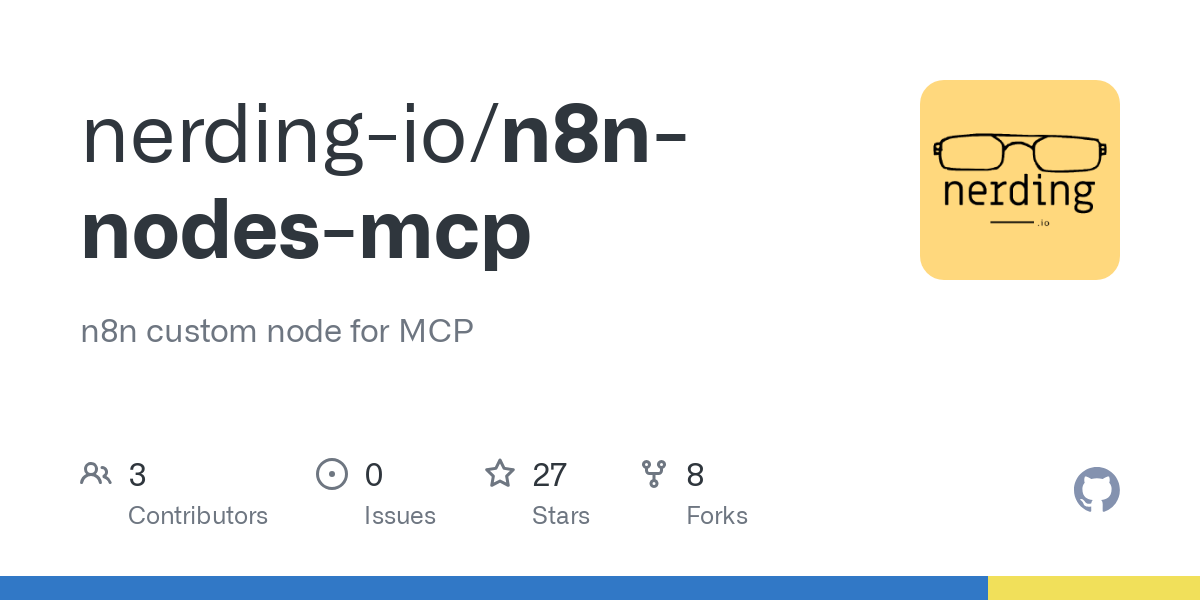

I created a node for clients. I’ll work on servers next. However feel free to contribute.

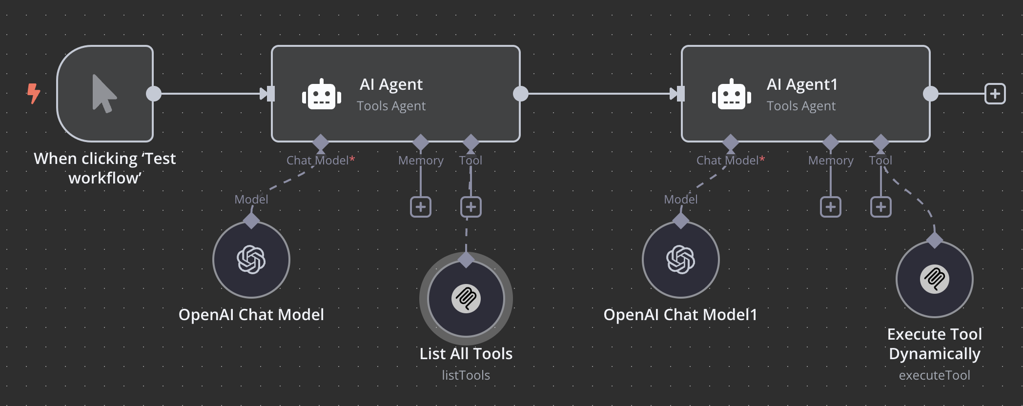

Would it be easier to break that up into multiple agents? Like have an agent list your tools, send that to another agent to execute based with a expression.
Something like this? (might need structured output)
I you are asking for it to all be in one node I think that a limitation to the tool since you are require to name it.
Maybe I’m misunderstanding though. I just like to keep my Agents limited to a single primary task, then have a multi agent orchestration.
Thanks for the response! I think what you are showing is along the right lines.
So I’m looking for
  1. One tool to list all tools (i.e. tells me all mcp servers I’m connected to and the appropriate tools available) -e.g. shows me brave_search, weather Api, Airtable etc methods all in one response. Can I do that through the non SSE method? Can I do that with hosting on elest.io & if so, how?
  2. my agent can then pass to the next agent which has a tool connected (just one) that is executeTool but the parameters + tool credentials + tool is selected dynamically - I see that it looks like you’re doing that by connecting to an SSE mcp account, is that correct? How can I do this on elest.io as that’d be awesome?
Perhaps it’s my limited understanding of the SSE method as well as MCPs, but right now I’m connecting an executeTool directly with credentials used to install a specific tool e.g. Brave, so I therefore would have to create a second tool for the weather API, another for Airtable MCP etc, have I misunderstood that?
Thanks so much! Excited to get this working, I’ll publish a video about it once I do :grinning:
